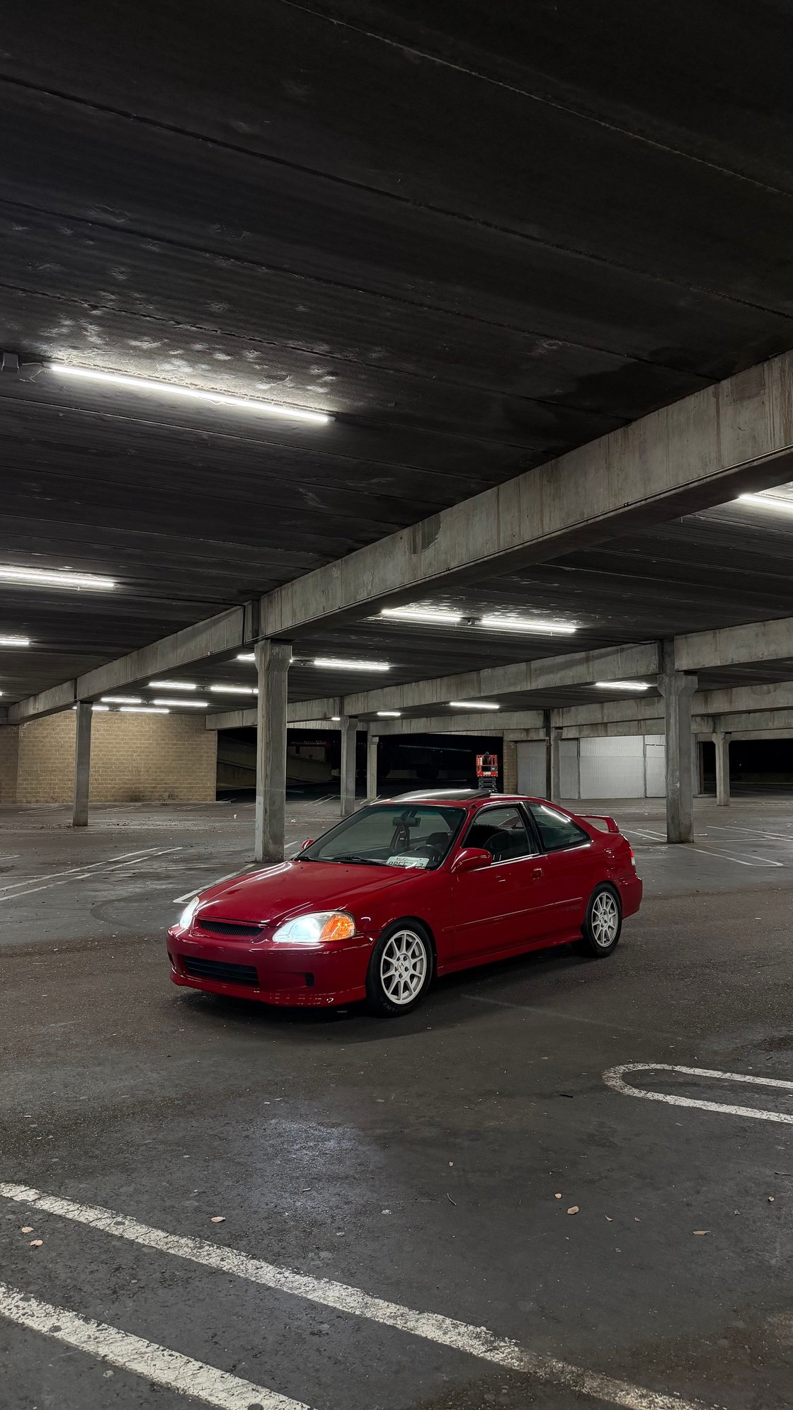

Here I am in the big 2026 reading this before buying a B16A type R block I found for cheap that recently had been worked thru. This definitely helped me understand what it needed when over boring to 82.5mm. I have an EM1 I want to show some love to and put a fun motor into it. So slowly ima build a type R motor for it. Thanks a lot. Keeping the Honda scene alive in Modesto Ca 🤟🏽
