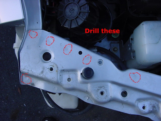

I just got my jdm conversion today, and I plan on doing my own install (yes on me for being cheap), but flamenco-T did his and his was perfect, his internet isnt working so he cant get on and show me exactly what to cut. However I took some pictures of my USDM Radiator support. He was telling me That I have to cut a few spots on the top of the USDM, and then cut the same exactly spots on the JDM radiator support, then swap them and weld the jdm to my Original middle section of the USDM radiator support. and then repeat the same thing for the bottom, he said its much easier to just do the top and bottom, then removing the whole radiator support.
If anyone could give me insight, and highlight the places im suppose to cut, that would be great.

Thanks for the help guys, also after talking to stan, it seems like i know what to do, the red circles are the spot welds i drill out. and the green lines are about where i cut the radiator support and weld the jdm top support.
anyone have any objection?

Absolutely do not cut off the USDM support there.
What you want to do is replace the USDM headlight bracket with the JDM headlight bracket (yellow section). You also want to replace the middle bar (green section). So do not remove these from each other. Here is what you need to switch:
Drill the spotwelds that lie farthest away from you around the engine bay:
Do not cut your USDM support at all. Drill out the spotwelds on the USDM headlight bracket and the two on the bottom portion of the middle support bracket. These ones:
Drill through the top of the USDM headlight bracket (yellow) very carefully so that you don't damage the "blue section" of the radiator support. To do this you might want to invest in a spotweld drill bit. A spotweld bit will help prevent you from drilling into the other part of the sheetmetal that you want to preserve. For a Honda spotwelds a 3/8 inch bit is perfect. Heres where I go mine: http://www.eastwoodco.com/
When you go to remove the JDM headlight bracket on your JDM radiator support keep the yellow and green section together. Cut the JDM radiator support here:
This makes it easier for the next step. Then turn the JDM headlight support upside down and drill out the spotwelds from that direction, so that you leave the JDM headlight support bracket undamaged.
Now put the JDM headlight bracket where your old USDM one used to be and bolt on everything else. Make sure the headlights, fenders, hood, fascia all fit well with no oversized gaps. When everything fits perfectly then clamp down the radiator bracket and weld/rivet/screw it on permanently.
I would suggest you look over the parts a little more so that you competely understand how it was put together. There are couple more steps you'll need to do after this as well.
Good luck!
