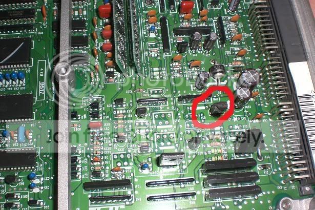

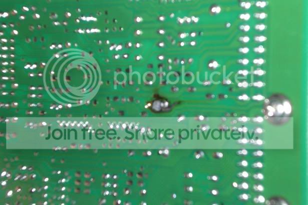

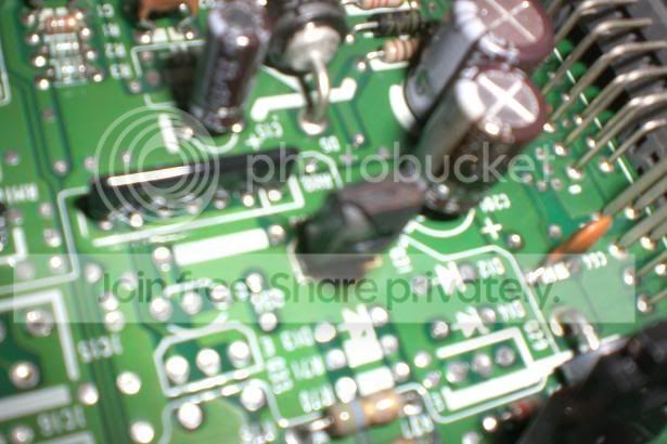

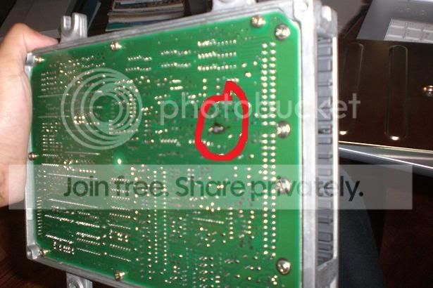

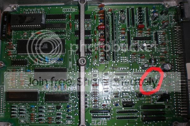

I pulled my ecu, found a crack in transistor of somesort. And flipped it over and pulled the cover and found it burnt aswell. WTF!!
What is the cracked part or the part i have circled?

http://forum.pgmfi.org/ , go there for any or all ECU questions.

thats is the same exact thing that happined to me.. lol
Messed up by switching the IACV and ITS.. fryed the ecu alittle. but my motor still runs fine and mine isnt even throwing any codes anymore.. but im still worryed if its effecting anything that isnt noticable.
ohh well i dont feel to dumb because this was my first motor swap ever. **** happins! lol please let me know what u do to fix your problem
