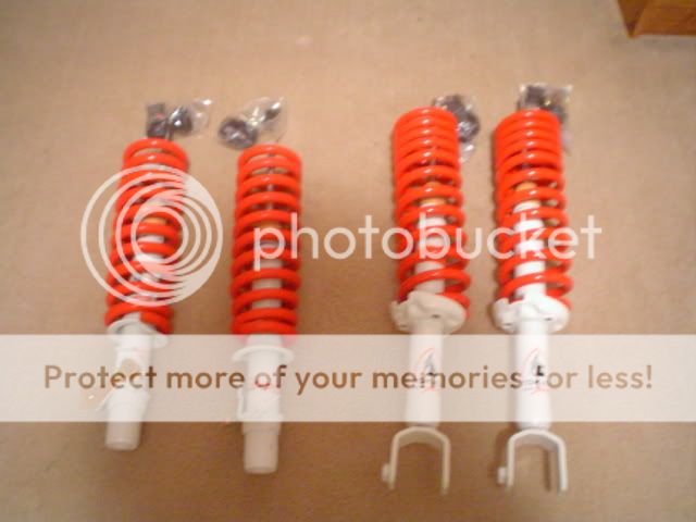

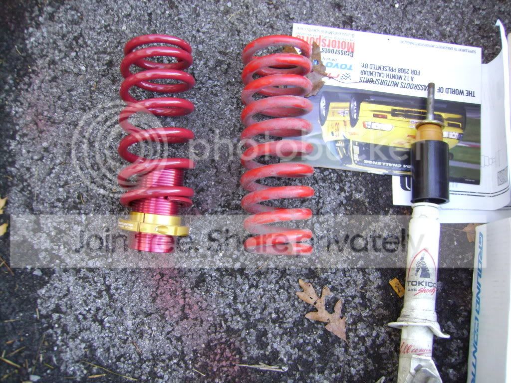

i had the same set up on my DA like over a year ago. it only lowered the car about 1 inch but i liked the ride. i later got GC's and sold the springs for 60 bucks.
HERES THE STOCK HIGHT
THE KIT
ON THE CAR
AND THE NEW SETUP
