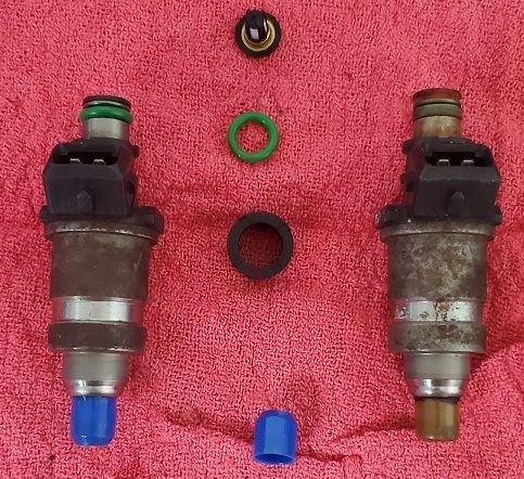

also sounds like you maybe having injector tick
I rebuilt\serviced the injectors on my B16a and they were noticeably quieter afterwards
I used a kit from these guys
https://theinjectorshop.com/
x2 on injectors. I had cylinder 1 injector not shoot any fuel in my cylinder because of a loose connection or faulty adapter. It would run great cruising then doin a pull it would run on 3 cylinders and sound like a wrx like how OP sounds in the video.
OP, Try swapping out your injectors if you got some lying around and check your fuel pressure at the filter and fuel rail.
also change out your spark plugs, plug wires and rotor if you haven’t already.
