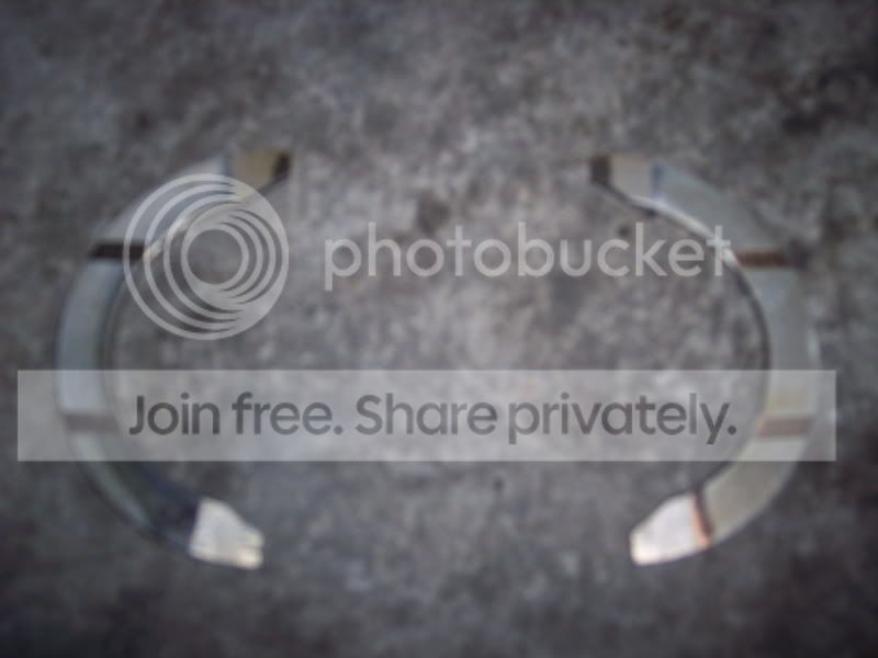

here are pics of what fell out
[IMG][/IMG]

They can go in just fine with the crank in. Just take the main cap off between 2 and 3, place the washers on the crank and then just spin them untill they are between the block and the crank. I know it can be done because I have done it before.

You don't need to remove the crank. You may have to remove the main bearing girdle but you don't need to pulle the crank. And I believe that the grooves point away from the journal. You should be able to spin the washers right int. Good luck.
