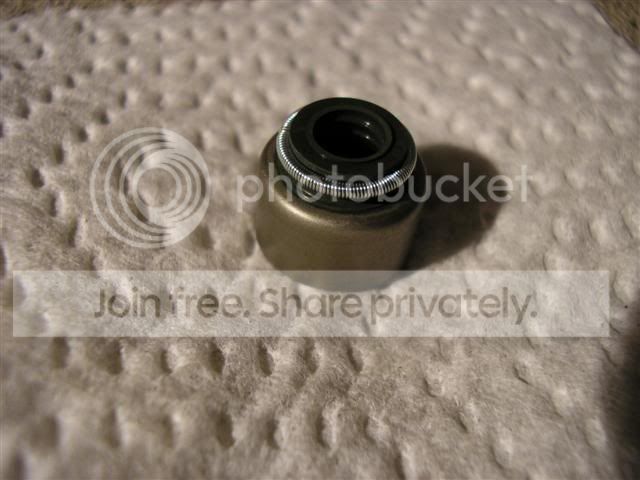

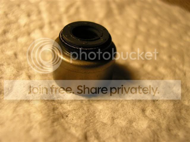

I'm pretty certain exhaust and intake valve seals are NOT interchangable. Maybe you got the wrong parts. They should both have small springs wrapped around them. The ones on the exhaust valve seals should be black, and the ones on the intake should be white. At least that's how it is with OEM valve seals.
here are some pics.
Intake Valve Seal:
Exhaust Valve Seal:
