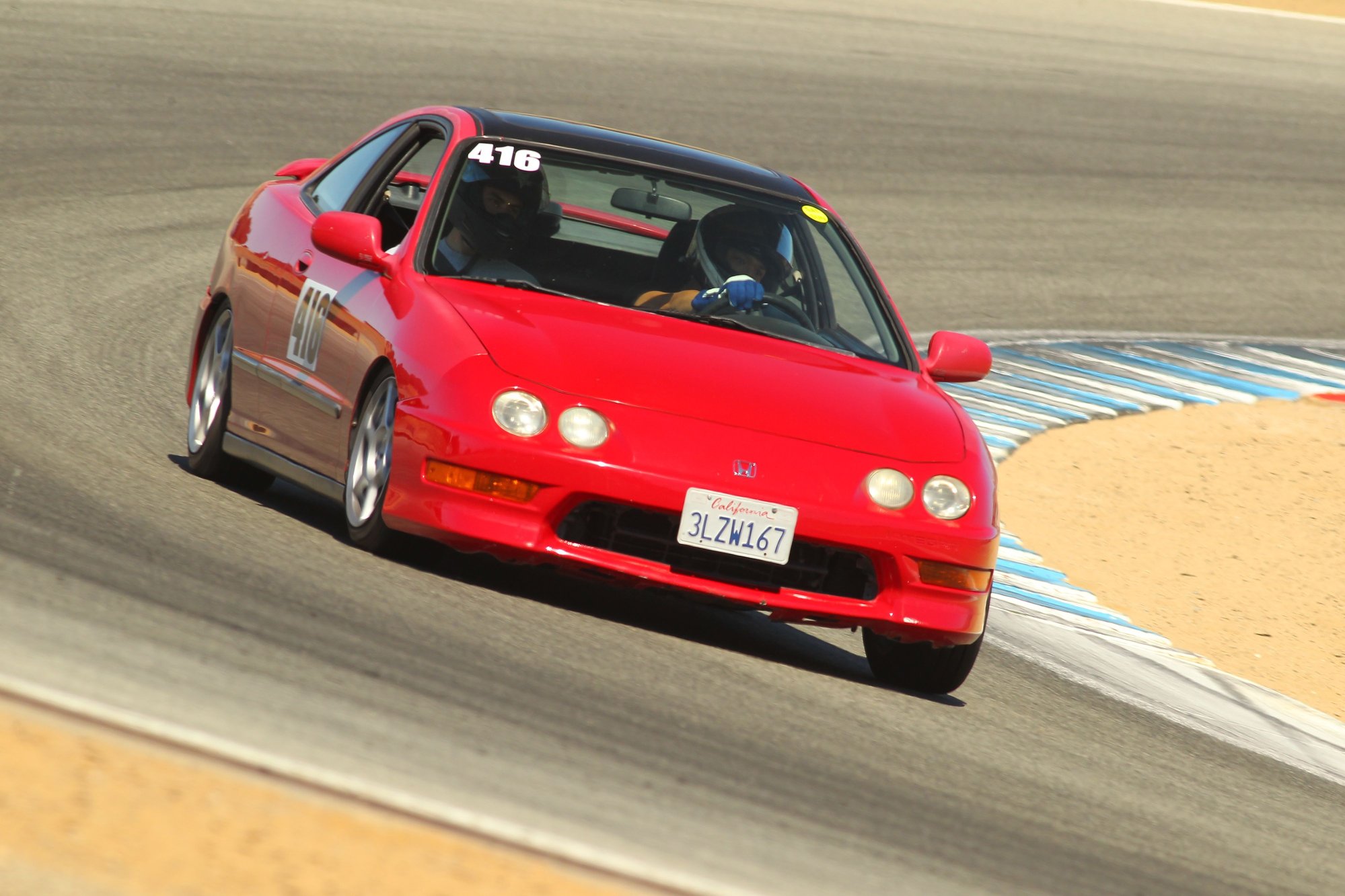

Track Day #1 - Laguna Seca
I've only started doing track days last year in my E39, but boy I'm hooked. The whole reason why I picked this car up is thrash its poor little B18B around the track and learn how to be a better driver in the process. I've only been to MRLS once with the E39 and it was POURING rain. So of course it had to start pouring when I took the Integra too. The car handled surprisingly better than I had anticipated. Going uphill after turn 5 was definitely a battle and the afternoon rain caused massive understeering problems when I tried taking turns at speed. Overall, smiles per hour beats miles per hour and it was a huge blast. I can't wait for the next track day. Hopefully I'll have replaced most of the worn out bushings by then. Onto the pics!
The lower radiator hose decided to start backing itself out 10 minutes away from the track. Knowing that I'm running a 200K+ car, I brought plenty of spare fluids for mishaps like this. Poured in some distilled water, made it to the track, worked the lower hose back on, and filled it up with distilled water/antifreeze. No time was lost!
I like this picture a lot. It looks like it could've been an old Honda class racing photo from the early nineties.
