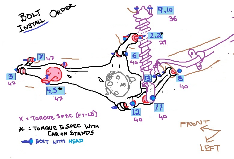

9 and 14 in your diagram are the front lower control arm bushing and the front shock bushing. Those are pretty important but they're hard to look at without removing the arm. The rear bushings are easier to see.
RTA bushing is 4,5 on my MS paint diagram and rear UCA is 1,2
I'm not sure you'd feel a change in handling as much as you would if you replaced more 'important' bushings like the rear trailing arm bushing, but I have to imagine it will still improve.
