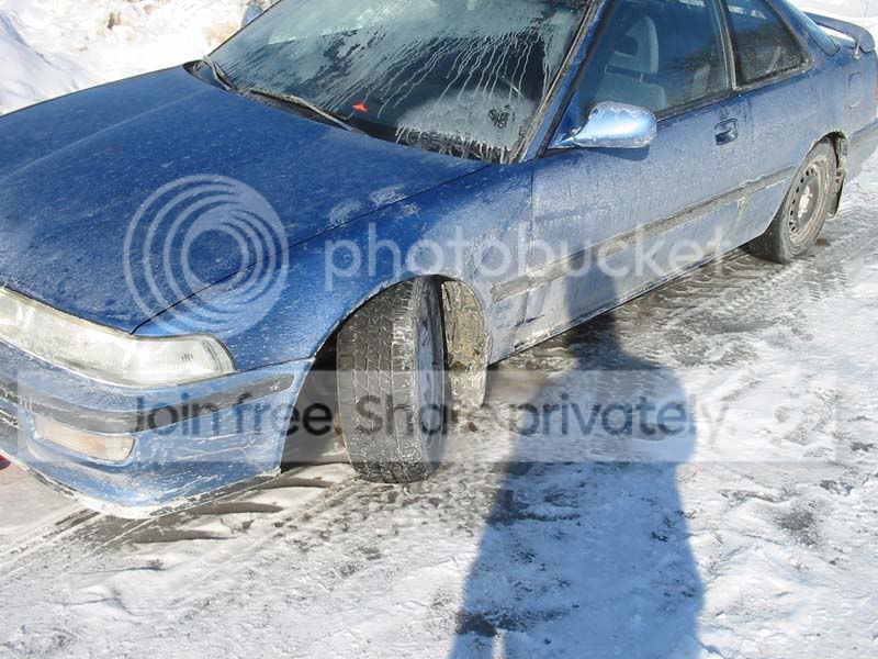

sheared the bolt right off actually, the front lower balljoint on my '92 gs. Anyone ever hear of this happening, seems rather unacceptable to me.
Fortunately i was only doing about 2mph at the time. I hear a metallic 'snap,' the left front end drops about 5 inches, and i get out and see the fender squished on top of the tire, which was pointing in an obscene direction.

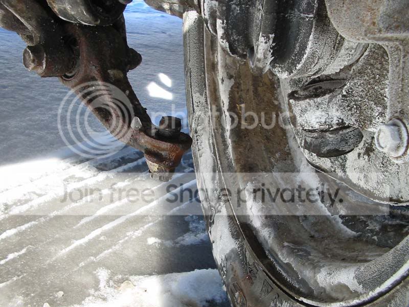

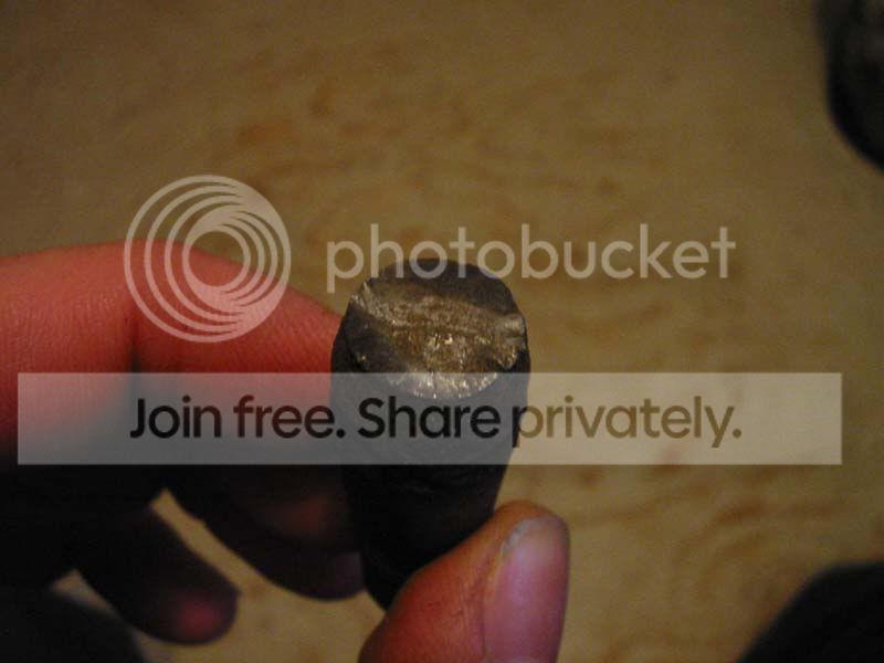

Well, i had a stunning revelation about half an hour ago. I was all dissapointed with honda over their crappy ball joint stud til i remembered somthing. About 2.5 years ago when i actually bought the car (for 750$ ), i took it to a garage for a safety, and the mechanic said i needed a new left lower balljoint (this one). I took a look and pointed out to the dummy that the balljoint was fine, but the castle nut was loose. I don't know how long, prior to my ownership, it was driven like that, but it was what likely caused stress on the stud, and it only now gave in.
check it...
a jack assisted recreation of what i found when i stepped out of the car (except it was lower)
parts don't quite line up
almost looks like some kind of burn mark around the fringe of the stud
