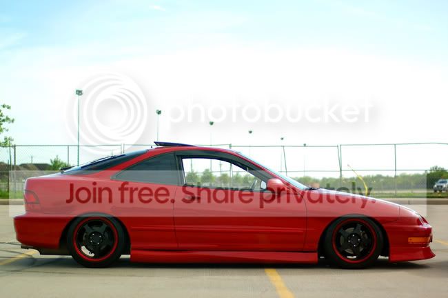

yeah it looks really clean and less sporty i am sick of getting pulled over , i am probly gonna go wingless
