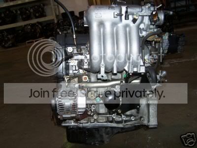

ok since you think your so smart then did you realize that the b20b comes with 2 different manifolds?
http://cgi.ebay.com/ebaymotors...wItem
the one you posted and the one i posted. and the runner lengths are almost identical as the ls intake manifold. as a matter of fact ill even go home on my lunch and take a pic of the b20 manifold that came off the motor and the ls intake manifold that got swapped over form the ls motor. so dont be such a smartass!!
