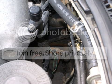

It's kinda hard to explain, lemme see if I can get a pic of it.

Default Re: O2 sensor plug location (huskmusk)
behind and below the IM

Default Re: O2 sensor plug location (fast95se)
Thanks for the helpful pics.. I have located the plug but they do not match up because the motor is a 2000 b18c5 and my car is 94 ls. What shoudl i do in order to solve this problem?
Thats because your '94 is OBD1, and the motor is OBD2. I'm not sure of the wiring, you might be able to get a connector at a junk yard and wire it up, but I'm not sure of the specifics. Good luck.
