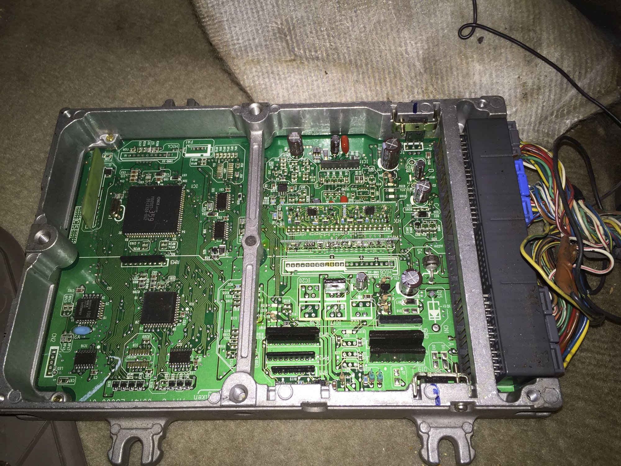

Do you know that your ecu is by a passenger's right foot, if you had a passenger in your car?
Take the plastic cover off and take a couple of photos. Mainly of the connectors and someone on here can tell you what you have.

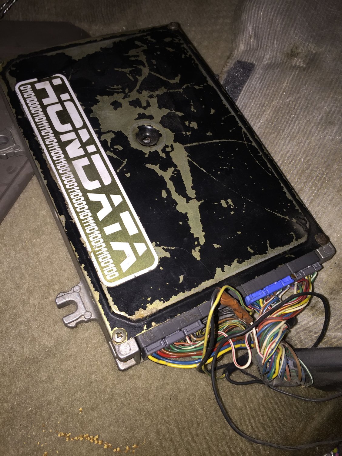

Find the label on your ECU.
That *looks* to be an OBD2A setup. But I dunno how to explain the hondata stickers.

Looks like it might be a obd2a gsr ecu with the vtec wire tapped into the harness, theres no jumper harnes for the ecu so its not a obd1 or could be but it doesnt have the conversion harness. But it also looks like its been open to be chipped for hondata so it could be a obd1 ecu that is chipped with hondata. Id confirm what ecu you have before going any further, you could have the wrong ecu causing your issue or a cell in the ecu causing the engine to run rich. open the ecu up and take a pic for us and find the ecu stamp code.

P73-A03 is the USDM 97 and 98 ITR ecu (OBD2a)
P73-003 is the 98 spec JDM ITR ECU (OBD2a)
P73-A04 is 00-01 USDM ITR ECU (OBD2b with immobilizer)
The JDM P73-003 should run fine, but it's map is slightly different from what I have found out. Also, the JDM ecu does not have all the sensors that the USDM ecu has such as knock, and the vtec pressure sensor (possibly ELD as well as others).
