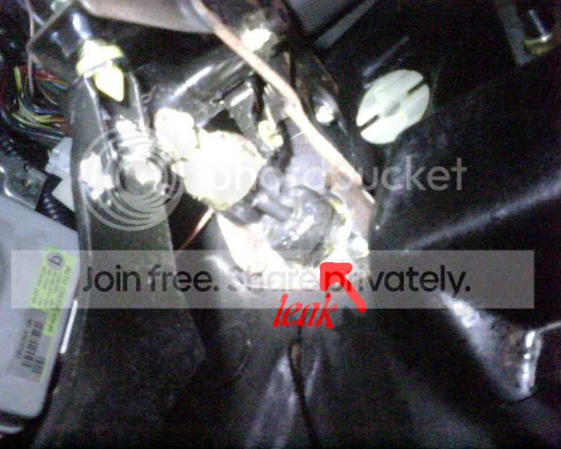

Thermostat...head gasket, fan, the list goes on and on...last one I had like this was a thermostat sticking. As for the clutch...many clutch master cylinders leak inside of the car near the clutch pedal of course. Look up in there with a flashlight, and see if anyhting appears to have been leaking where the rod goes through the firewall. Typical honda issue. Good luck!

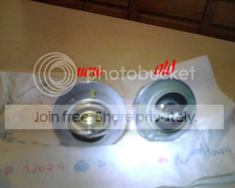

yea well it ended up being just a thermostat thank god. i replace it and everything is working fine, no overheating....thanx for all the help!

Default Re: need help asap!!!!!! (weavertime1)
as for the clutch i checked and it is leaking right where you said.... so now im going to replace it ill post pics.

you can see the difference in the two.
this is where its leaking right above the clutch pedal

Default Re: need help asap!!!!!! (hondakrazy)
yes sir!!! Just as I expected! Good luck!
check your slave cylinder too
