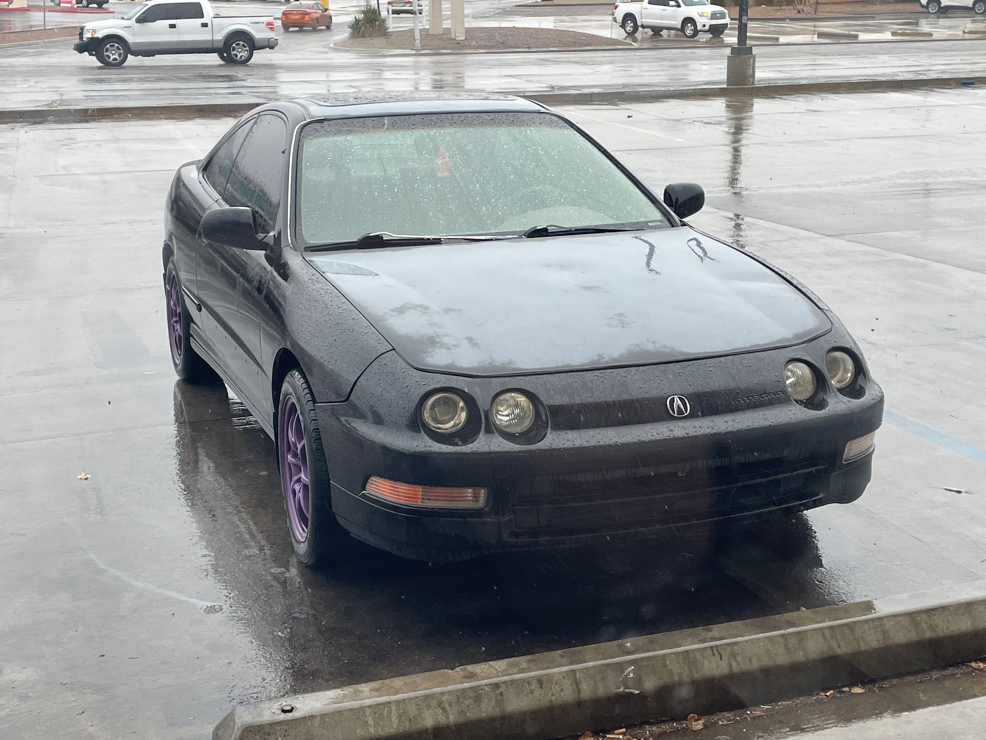

Hi everybody my name as Will and I have a problem. I drive a 94 Integra with a B18B1 and I’ve been having a problem getting my oil pan to seal. I have done my oil pan gasket three different times, have gone through 2 BRANDNEW oil pans and two different kinds of gaskets and I cannot get it to seal. I have had a buddy who has owned several Hondas help me out with the gasket but when we were finished it still kept leakin. When it started leaking before I even touched it was leaking a lot worse than it is now I have been told several things that could be wrong, that my block is warped, that my block is cracked, they didn’t use enough sealant etc. etc. I just wanna know if anybody has any tips on where to go from here cause I have no idea… TIA ( pic of teggy below)

1st...that's a nice photo of a clean Integra.

Very nice looking car. I have a 98 now but I think the 94-97 look better and miss my old red LS.
