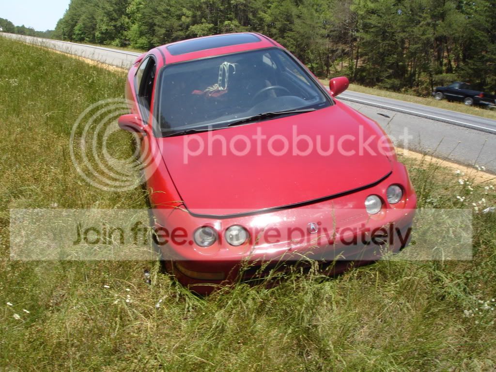

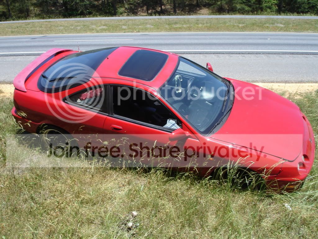

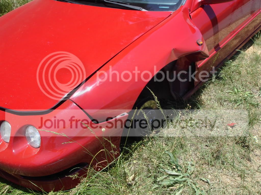

Wednesday Part 1- Leave at 5 A.M, everything is going good and making good time. Then about half way through Alabama,
Doing about 90mph start feeling the steering wheel shaking and a thump thump coming from the axle or wheel, I wasn't sure at the time. - As soon as I heard it I began slowing down to I'd say 75-80mph and begin merging to the right lane in order to pull off the road and check around. - Then wheel starts shaking very violently and a very loud thumping noise, before anything could be done, I see a lug nut shoot off the driver side of my car, then the front of the car drops and I hear the sound of metal against concrete, see the wheel going towards the median. - I grab it with both hands, slammed foot on the clutch, hit the brakes, but didn't slam them, slid the car safely to the brake down lane, kinda stop half way into a ditch. - I could not believe what the expletive just happen. I cussed screamed and punched the steering wheel.

The car was towed to a good shop in Alabama, waiting for an estimate today, hopefully. Insurance should be covering it all. I just have to pay deductable, I have full coverage BTW.
I ended up finding the rim after I waited at the shop for 4 hours for my mom to get me . We stoped by where it all happen and found the rim in the meadian, the rim was in great condition besides the scuff mark in the tire from the fender landing on it, also the inside of the rim has some nasty marks from the rotor spinning around.

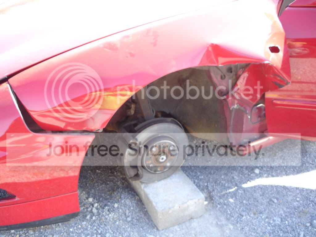

Do you think whoever did your timing belt forgot to tighten your lug nuts to spec?

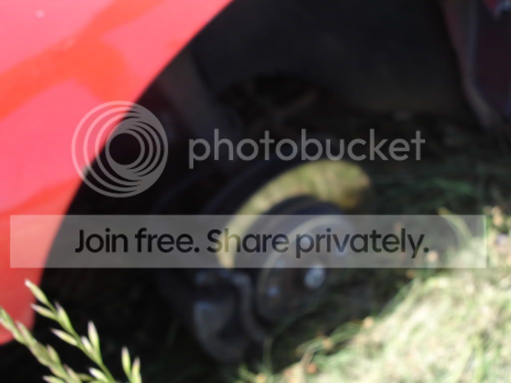

in the pics it looks like all the wheels studs are broke... . i thought i had bad luck, but thank god for full coverage

Thats what I'm trying to figure out right now...

Default Re: (dc4_wHORE)
yep, all studs broke off, going through all the b/s and possible holding the shop responsable for what happen, since they were the last to take the rim on and off...

That is one horrible week. I would be cussing away also. Almost an unbelievable story but u got pics. Hope it gets better by beating the **** outta that rental </TD></TR></TABLE>
as far as I can tell, they over torqued the nuts on with the impact gun. Now that I think about it, when trying to get the crank pulley bolt off to change the timing belt, they got their "good gun" to get it off cause the damn thing wasn't budging. I believe they used the same "good gun" to put the lug nuts on...

Default Re: (Spoon07)
Or, they only finger tightened the lug nuts and forgot to torque them to spec. Then when you were on the road, they loosened up and that caused the wheel to start having play on the hub. When this happens at high speed, all the lugs will break like twigs.
