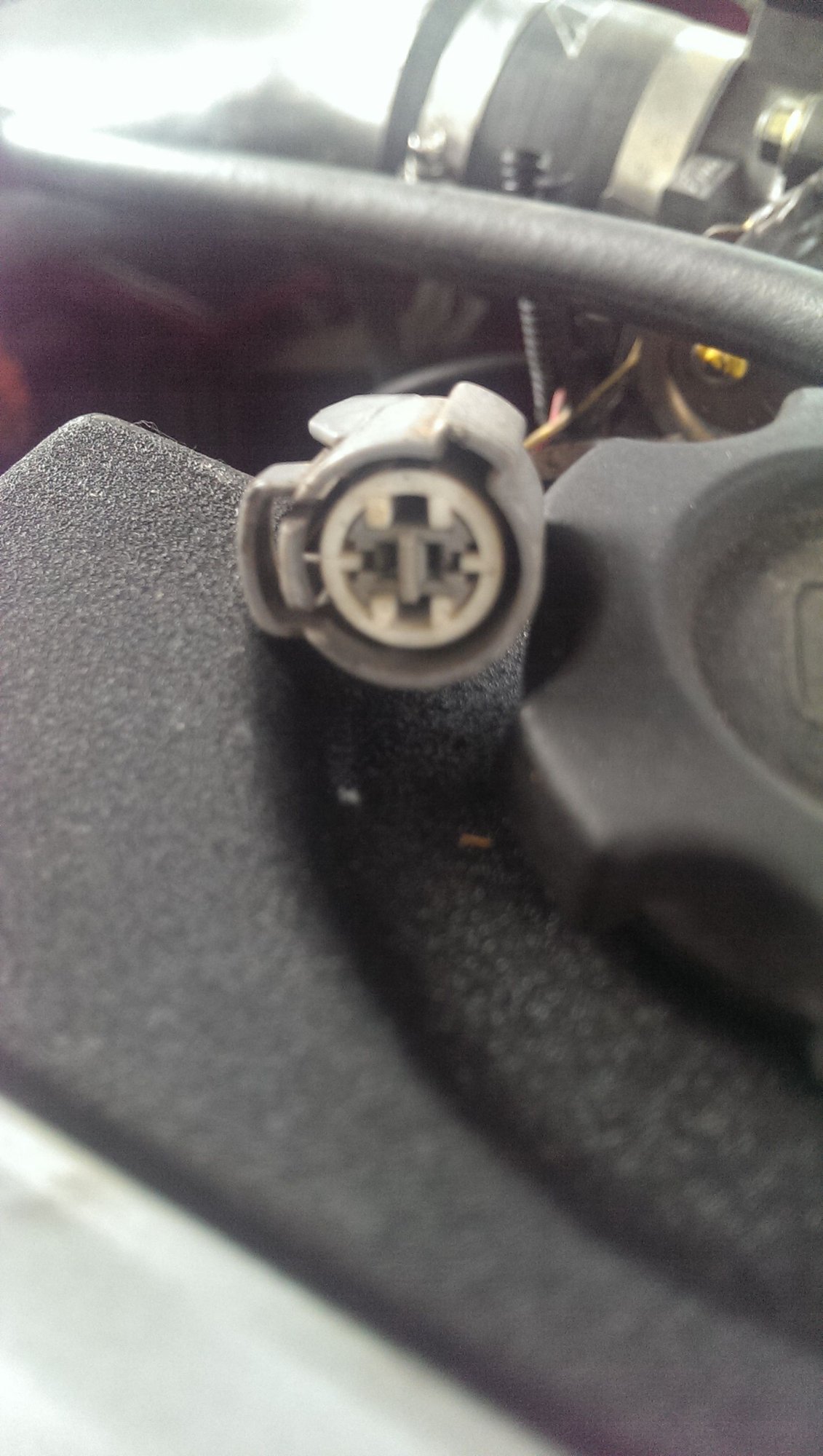

Im trying to figure out where this connects to any help? And when I unplug the map sensor the car dies, is that normal?

probably the TPS plug, the map and TPS plugs fit each other you might have them switched.

That other plug thats just sitting there on top of the intake coupler ^^ looks like it might be for the IACV or the IAT sensor on the intake manifold.

on the back of the intake manifold! you can see it on the last pic you posted!!

It should go to that or the IAT sensor. unless its a swapped engine like a ls or C5 swap using a gsr engine harness which leaves a few sensors that are not used.
