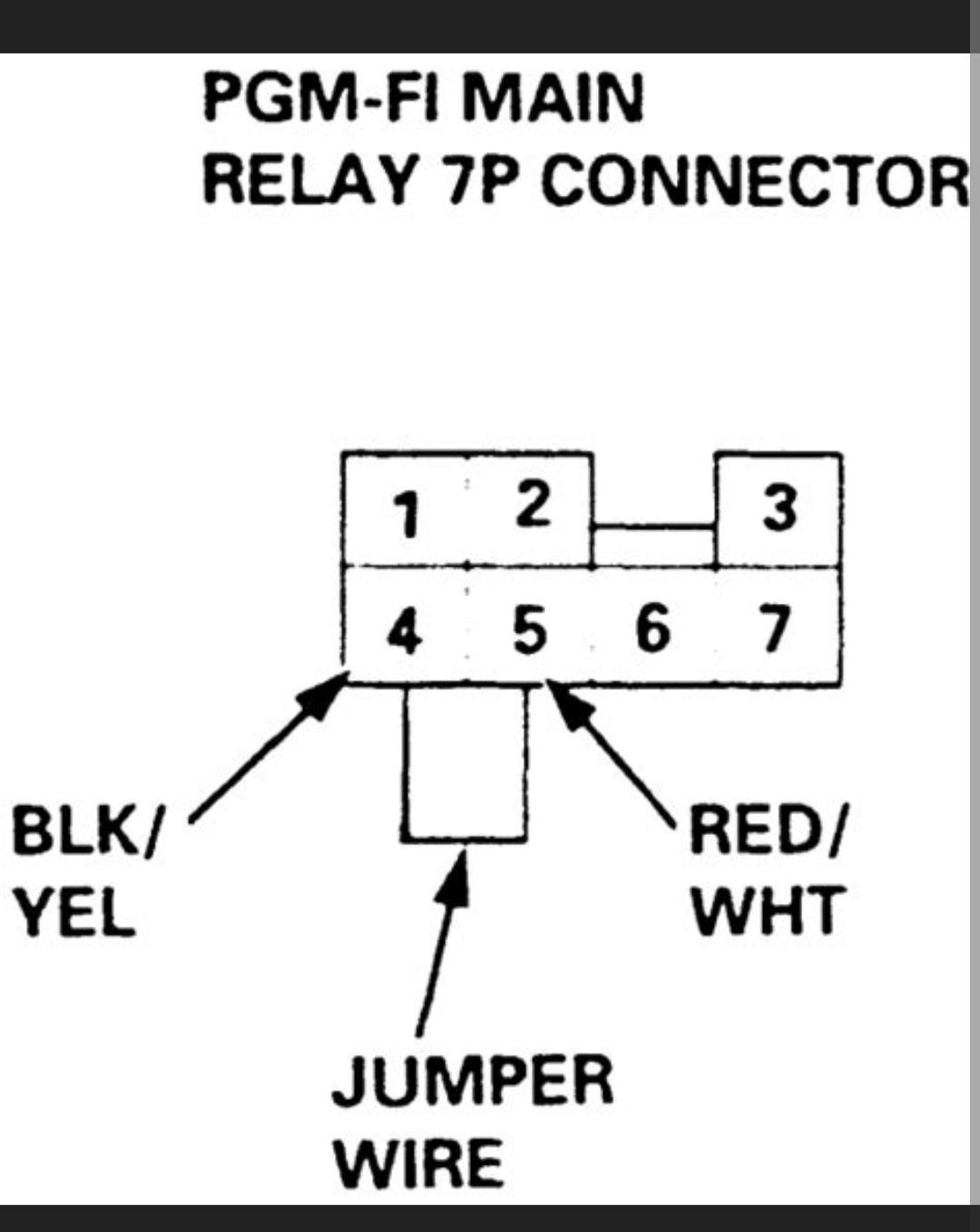

New to the forum hello!!! I have an 87 integra and iv been having a problem very recently where it doesn't start always. I simply don't hear the fuel pump prime all the time, but if I play with the ignition a bit it will start up. Once it is running it does not have any problems staying running.This has only started in the last few days, iv already ordered a new relay but it will be here on Friday. I looked online for a way to jump the main relay but when I tried it it did not seem to turn the pump on. Just wanted to check im looking at the right diagram for jumping pins.
just want to be sure I'm jumping them correctly as it did not do anything before. I'm pretty sure it is the relay that's at fault but I'm not at home with my multimeter to test it.
thanks

Found the diagrams I posted earlier were incorrect. Found a better one after I got the car towed home. Relay was bad after testing it. New one in the mail for Friday.
