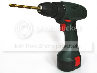

Any standard drill will work you just have to lines things up so it will be pretty f*ing rad

LOL drill that your head
