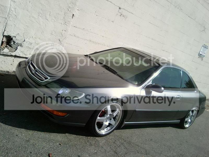

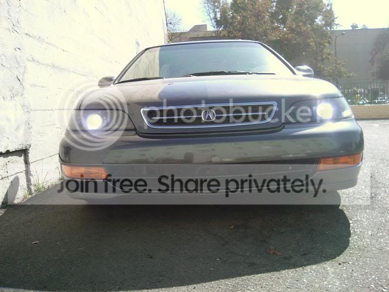

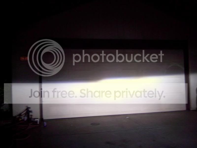

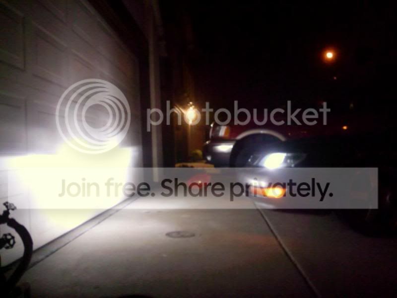

my retro fitted cl
so yes,
you have to
1.buy the real JDM HID integra headlights
or
2.retrofit hid projectors into your non HID jdm integra headlights,(i heard s2000 or tsx were the best to use)
like i did
for more info for retrofit
http://www.hidplanet.com
otherwise you would have a pretty shitty dispersed beam only plugging in a HID ballast system
