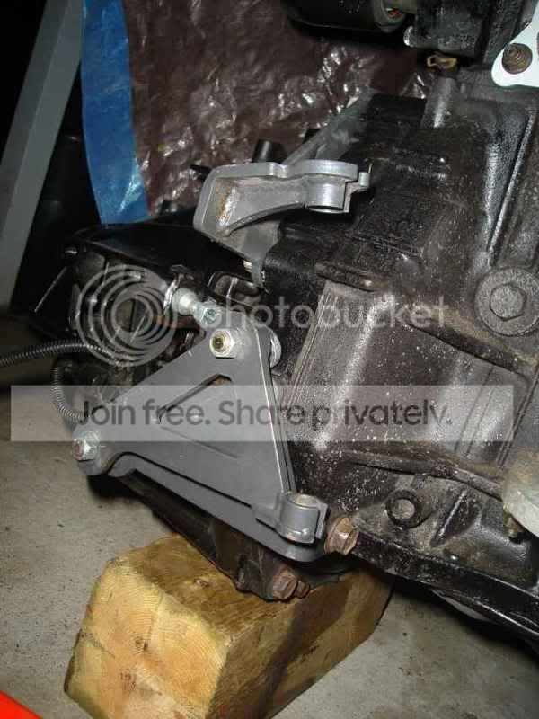

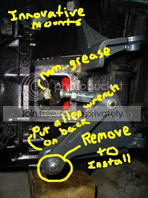

D'oh, I thought you meant the other way around. Well here's the pictures for my Cable-to-hydro kit. Maybe it'll help.
