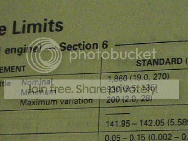

B18c
Borrowed from TI.net

so what would you do if you have a compression test of 195 195 195 190 across the board????? What would this mean???? is it dangerous???? what would you have to do to get the compression up to 200??

think wot could jump me 80psi? lol

i think he is fine- its just a used motor - once it dropped below 170 worn rings etc

You need to make sure that your gauge is accurate to start with. I have heard cheap gauges can be off by a lot. What's more important is that your number are all close to each other. From that stand point you're lookin good.
