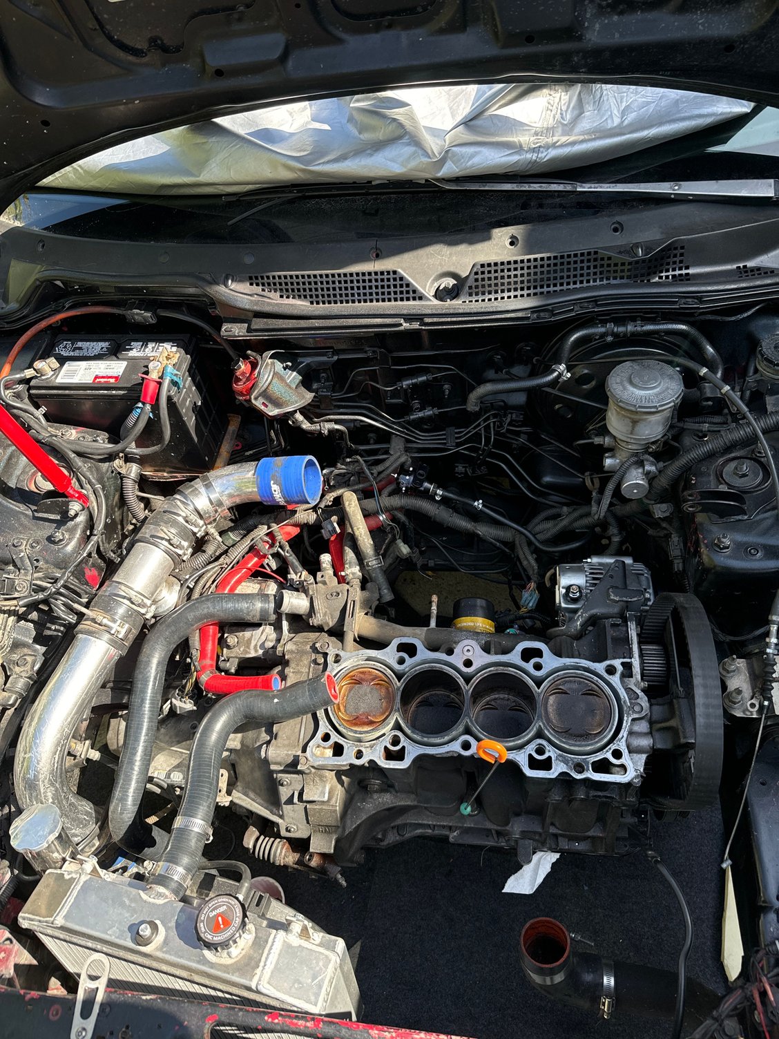

I just need to remove the motor mount bolts from my engine and it’s ready to be lifted but how should remove it. Do I need chains or straps to wrap around it? Also do I remove the rear motor mount first then the 2 side ones?

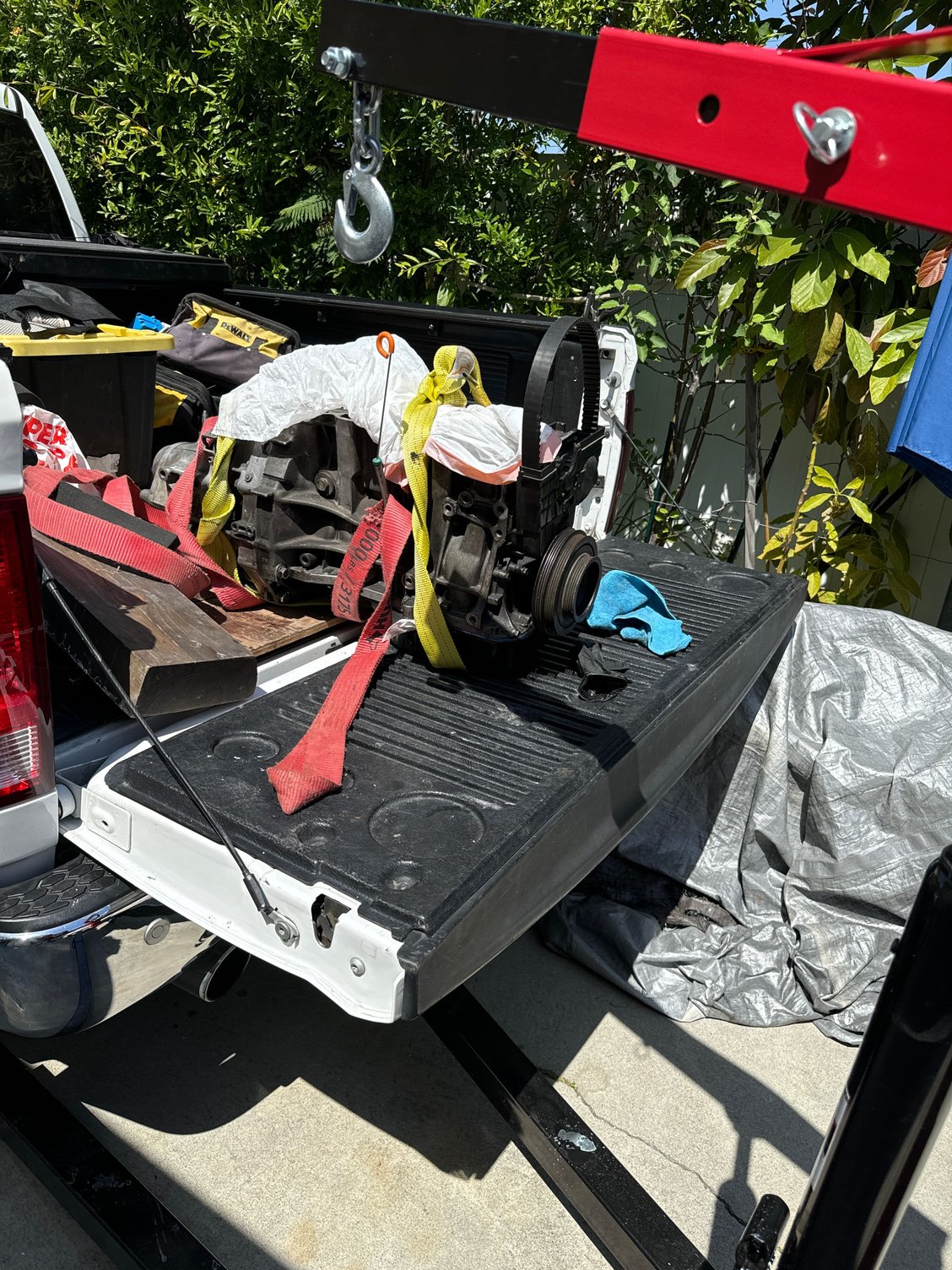

I got it out it was a bit difficult and I lowkey f’d up my front bumper lmao but i should’ve put the straps around the transmission evenly. It was lopsided/tilted when i was lifting it out and it hit against my front bumper and bended it. But I started stomping on it and it fixed itself lmfao. Anyways I’m going to use that as a learning experience so next time I lift it back in my car it won’t be all titled and it’ll be even.
