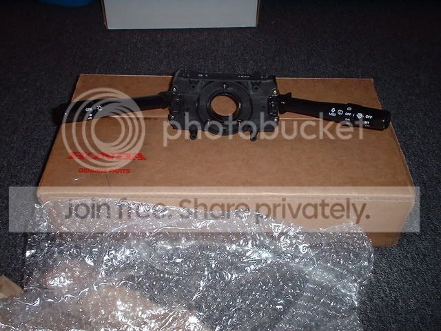

Can anyone help me out with instructions on replacing my headlight switch. I'm sure it's not too difficult but would rather be safe then mess something up. I ran a search through the old archived threads but couldn't find any complete answers. Thanks!

its really easy... assuming you have a g3.... i just did it a lil while ago...
Basically, all you have to do is take the steering column covers off..... undo two screws on the side that you should notice easily..... and it pulls out to the left...
you see the two screw facing on the front... those are the ones you need to take off.
