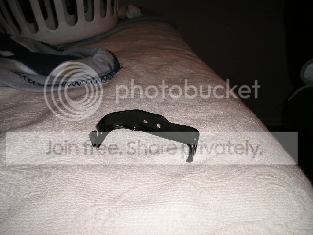

You need this bracket along with your gsr cable
It mounts to your firewall. Grab it from any acura dealership.

you dont need this to work. my gsr dont even have it. i took it off to bolt my benen tri-pod on.

do you happen to have the part number for this bracket??
