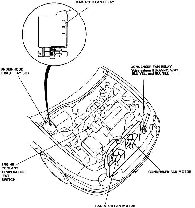

Today i changed the timing belt/water pump on my 94 integra. I added new coolant, however the car is overheating. i attribute the cause to the fans, which are not working. I checked the fuse for the fans and it apears to be fine. Could this be a relay? I did spill coolant on one of the fans. What else could cause the fans not to run.
thanks
Old Jun 20, 2005 | 03:07 PM
97tegGS's Avatar
Posts: 1,146
From: Chambersburg, Pa, USA
Spilling coolant on the fan would have nothing to do with it. Find the thermo temp switch. Its faulty.
Once the coolant reaches a certain temp it will click the fans on.
"ON" Temperature 196 - 203°F (91 - 95°C)
"OFF" Temperature Subtract 5 - 14 °F (3 - 8 °C) From On Temperature

Did you bleed the system??? if not you could have air stuck and that will cause over heating
Old Jun 20, 2005 | 03:43 PM
97tegGS's Avatar
Posts: 1,146
Yes, but I don't believe it would casuse the fans not to work, would it? UNless there is a bubble at the stat or the switch?
Old Jun 20, 2005 | 03:54 PM
stumpyf4's Avatar
Posts: 1,445
From: Mrs. Sauga, Ontario, Canada
Default Re: (97tegGS)
<TABLE WIDTH="90%" CELLSPACING=0 CELLPADDING=0 ALIGN=CENTER><TR><TD>Quote, originally posted by 97tegGS &raquo;</TD></TR><TR><TD CLASS="quote">UNless there is a bubble at the stat or the switch?</TD></TR></TABLE>
Bingo!!
I installed a flushing tee in the upper heater hose under the intake hose to use as a bleeder because I had this very problem after changing coolant.
Old Jun 20, 2005 | 04:17 PM
erek9's Avatar
Posts: 2
From: madison, wisconsin, us
thanks alot, i will try replacing the ect switch
