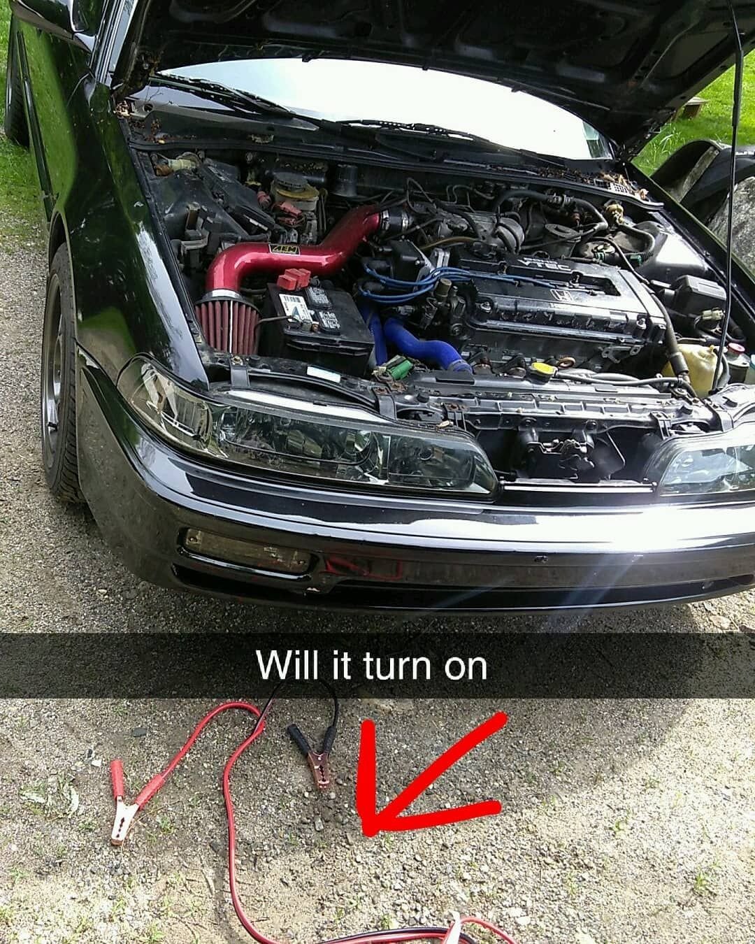

Sorry to bring the dead up but I do like 🧟*♂️s
Am running a automatic lsv but my ecu is obd1 gsr chipped, but my car is da9 obd0 tcm. Runs great
Pic from last summer
