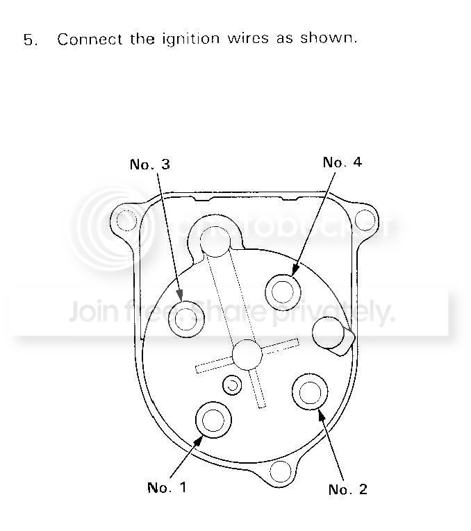

how to wire it up, help
Old Aug 3, 2008 | 08:58 PM
rebar71's Avatar
Joined: Jan 2008
Posts: 144
From: CALISUX, CA, USA
I'm feeling generous...

well its wired up correctly, but its still throwing code 9, ive herd its my cyp sensor, but iono where that is, and ive also herd its my dizzy but ijust got a new one put in so iono what it is

ha thanks guys, i had the 3rd and 4th switched up, well the ecu is still tellin me CYP is messed up, does anyone know what this means?
