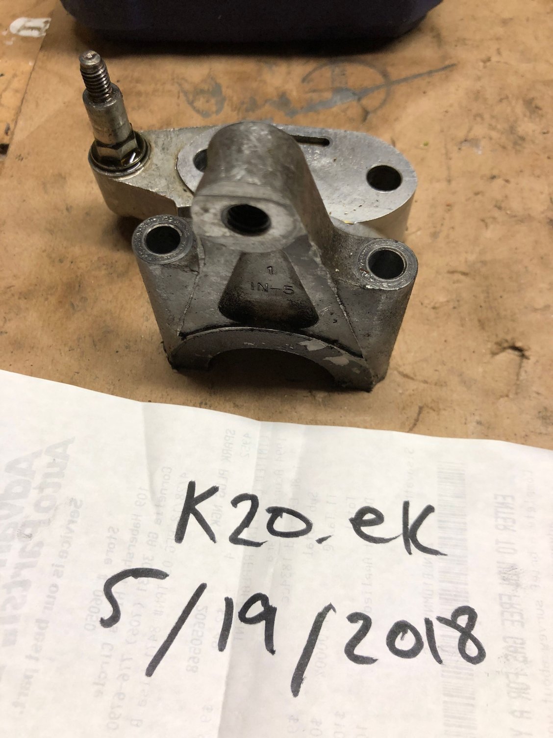

Camshaft holder.
I have b18c1 camshaft holders laying around to sell if you need it. Pm me

can you show me the pic of the part k20,?

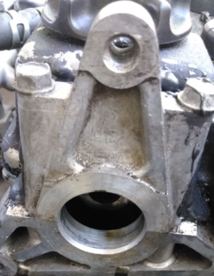

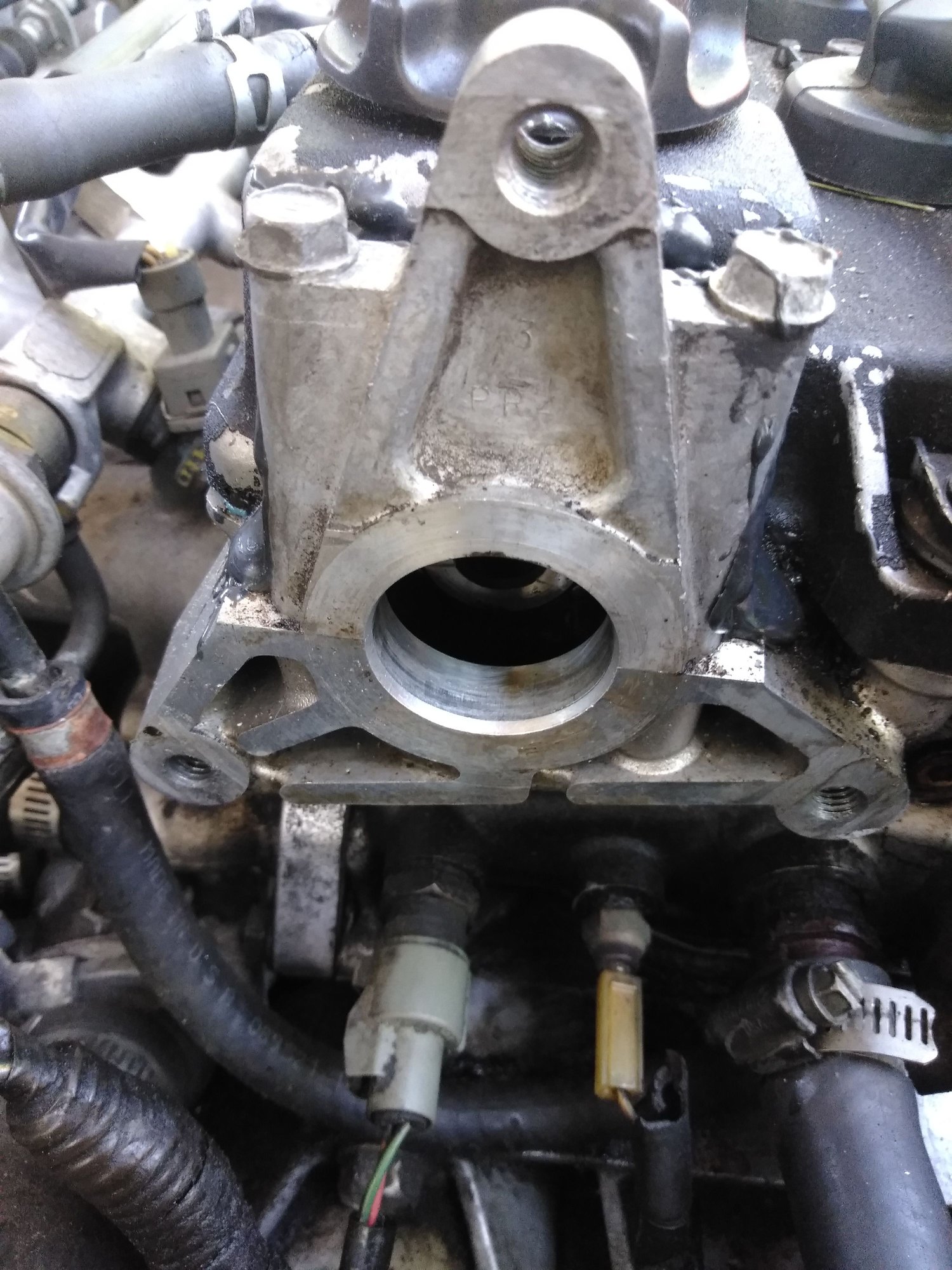

I had a high hit that broke my valve cover and one of its posts. The post threaded in to the cam holder, at 9 ft/lbs.
I had my cam holder welded, instead of replacing it and going thru the hone alignment.
The damage is circled in red, below.
