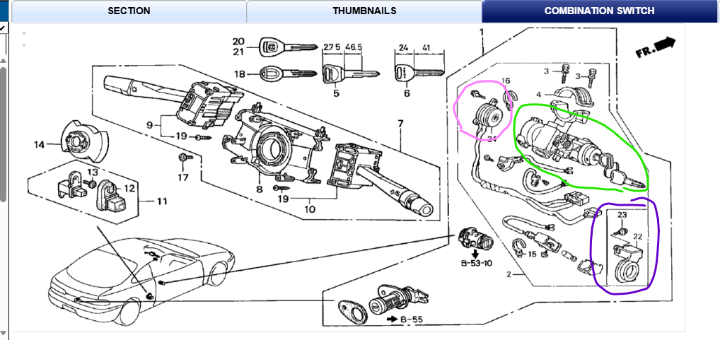

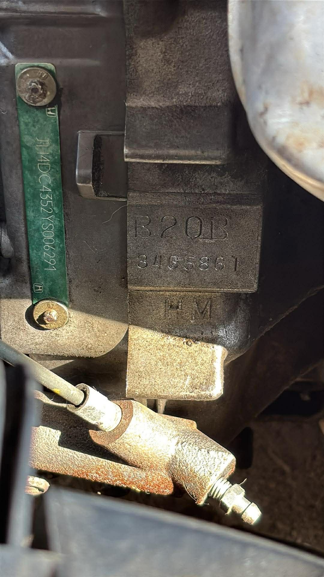

I just bought a 2000 Acura Integra (DC4). My problem is the key is very difficult to turn and the ignition switch has been cleaned yet the issue persists. Is there a source for a replacement or should I convert to OBD1 to eliminate the immobilizer in the switch? Engine is a B20B.

You can replace the lock cylinder (green circled) and/or the ignition switch (pink circled) without damaging the immobi unit (purple circled) - it just screws onto the end of the lock cylinder.
The lock cylinders definitely get crappy from time to time, and now all of these cars are pushing (or over) 30 years old. pop the column cover off, unscrew the ignition switch, and see if it is sticky and/or frees up the lock. Replace as needed. You'll have to use a punch and hammer to tease out the headless security screws, replacements come with the new lock cylinder. A locksmith should be able to re-key the new cylinder to match your old keys/VIN if you so desire.
I wouldn't go through all of the trouble to convert to OBD1 just to disable the immobilizer. It's easy enough to get a dummy immobi board to unsolder and replace the one in the ecu: Doctronic - smart solutions - Mobilizer-FX01
