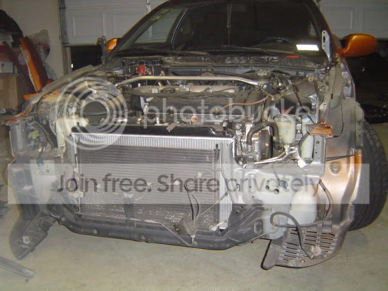

all you need it the T bar. just drill out the old one and weld on the new one. its pretty easy. it should line up perfectly. heres my car with the t bar removed
