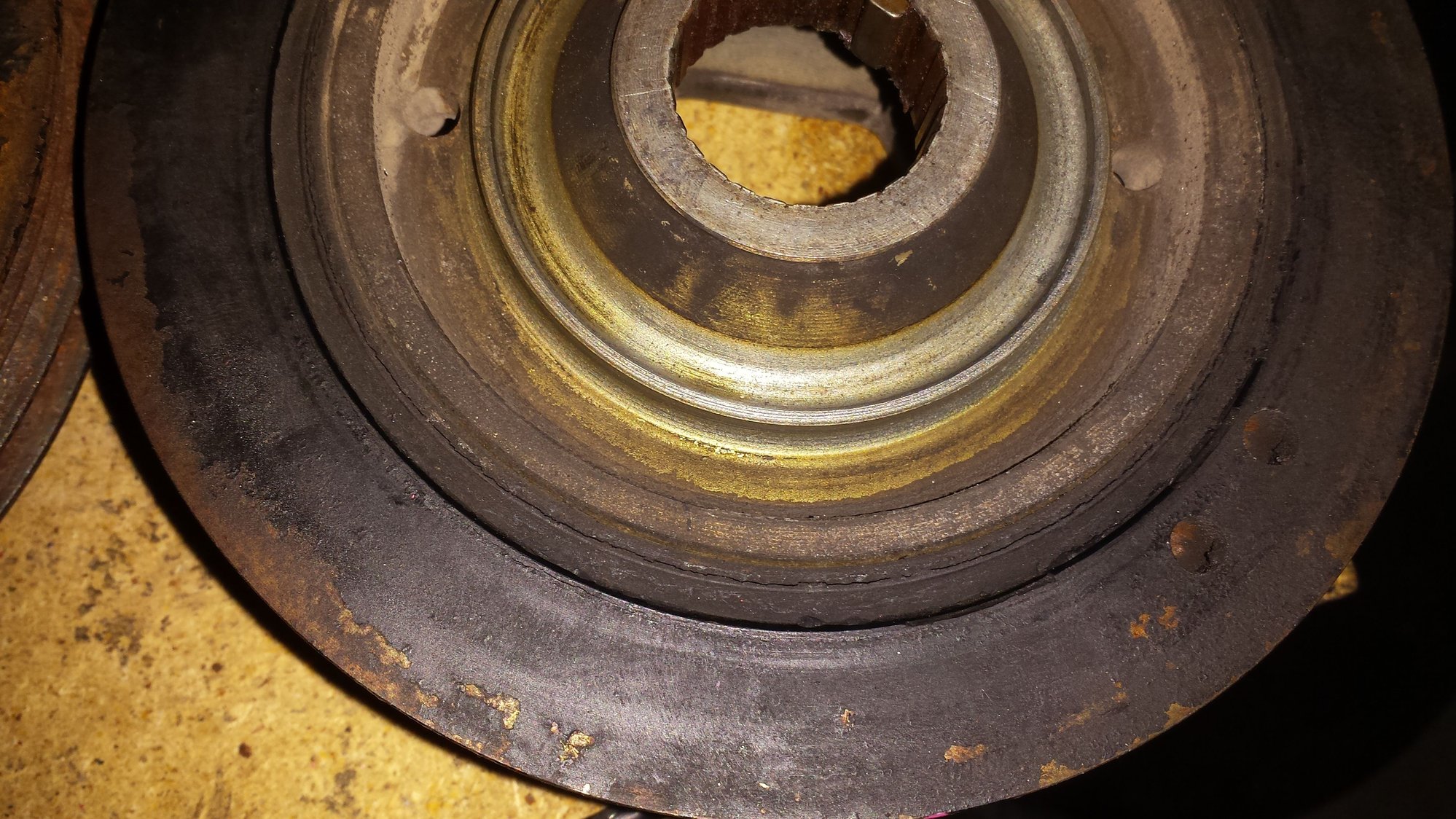

Id likely start with checking the alternator, belt, and especially crank pulley! I know on my 91, I was getting a weak charge, even with a new alternator and battery. Didn't realize until almost a year later (new batt and alt were keeping it running with really no problem) that my crank pulley was so worn out, I could turn the in
ner ring separately from the ac/ps pump pulley!
