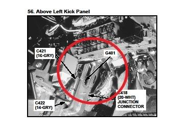

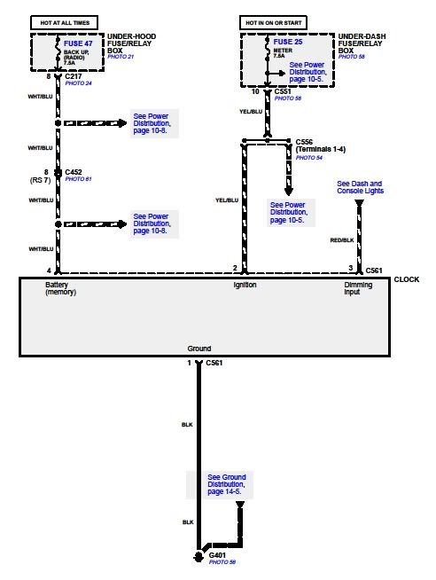

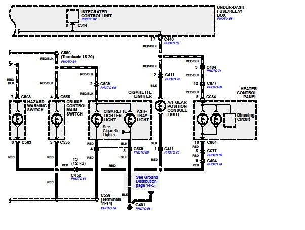

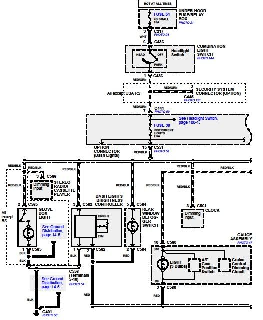

Looking at this The few things that are in common that would cause everything you described are FUSE 51 Under the hood and Fuse 30 under the dash. Fist replace them even if they look good.
Everything shared a common ground G401
Check that out first if nothing ill get more into it.
