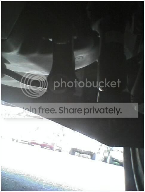

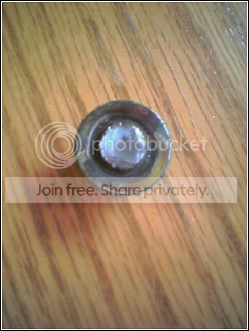

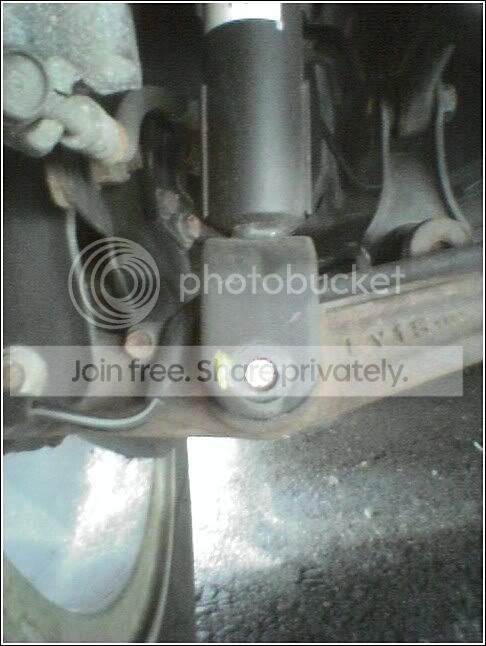

Well today while I was installing my new springs and shocks, I happened to snap the rear control arm bolt, one side looks attached the other is snapped, so I was unable to complete the work. My question is, where can I order this part from and am I able to have it taken out myself or will I have to bring it somewhere to get it done?
damn that sucks. those damn LCA bolts are known to snap. search around and read on how other people got theirs out. its a pretty commmon problem. its gonna be a bitch to get that thing out. i'd suggest looking around fine someone who upgraded their LCA and buy their stock one cause the stock LCA's are pretty cheap. i've seen them go for like 20 bucks. just get that and run to the auto part store and buy a new LCA bolt, its like $1.29 each. and i'd suggest getting new LCA bolts while you're chaning the suspension incase you have to take your suspension apart later. or you can use this oportunity to upgrade to after market LCA.
Well I went to three different stores (today is Sunday no dealership open) No store was able to tell me the part. I know its a 14mm bolt but what is the thread pattern....here are some pics...sorry to be a pain I was just mad because I lowered the front of the car but now I have the back stock so obviously driving like this will cause uneven alignment
this is the back side

Extractor kit or hammer will not work. This happenned to me twice already.
1. Go get an angle grinder at Home depot and cutoff wheels for steel cutting. Cut between the shock fork and the LCA bushings.
2. THen take out the other two end LCA bolt (better hope they don't seize up, torch them up if you have one before you open them).
3. Once you have your LCA off the car, buy some aftermarket bushing like energy suspension at jegs.com and bring them to a suspension shop ask if they are willing to press out the old bushing (with the broken bolt in them). You should be able to insert aftermarket bushings like energy suspension stuff by hand. If you choose to buy OEM bushing at dealer, then have them press it in also. Hopefully they'll do it for 20-30 bucks.
PM me if you have questions, I've been doing this for couple times with my civic and teg.
second day working on this car, i cut the shock and the bolt is STILL inside the bushing, this is the most annoying experience. Does anybody know if i could use a titanium drill bit or use something else to get the bolt out. If not I think im going to get a new control arm.

<TABLE WIDTH="90%" CELLSPACING=0 CELLPADDING=0 ALIGN=CENTER><TR><TD>Quote, originally posted by kupras »</TD></TR><TR><TD CLASS="quote">second day working on this car, i cut the shock and the bolt is STILL inside the bushing, this is the most annoying experience. Does anybody know if i could use a titanium drill bit or use something else to get the bolt out. If not I think im going to get a new control arm.</TD></TR></TABLE>
Read the thread. Those pictures don't tell me everything, but tapping the bolt out with a 1/4 extension and a hammer is the way to do it. Spray some WD40 if its hard to get out. After a few hard pounds it will pop out.
You gotta get a new bushing after that, though. As it was said earlier, either press it out yourself or take it to a suspension shop or friends shop and get it pressed. Get a new bolt, and you're set. Put some anti-sieze on it though so it won't happen again.
