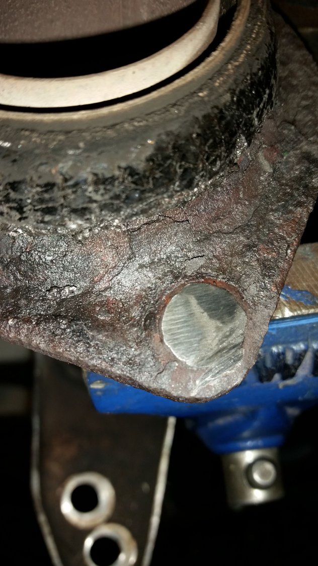

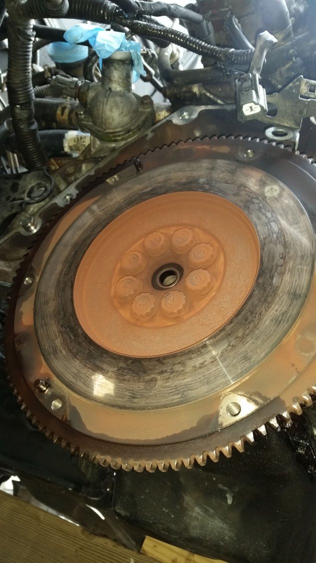

The clutch was toasted, a spring broke loose. Not 100% sure but I know 2 of the 3 previous owners and they never did a clutch IDK how but could this be the original? 190k on that if so. So with the trans out I can spin the center shaft in every gear, no noise no grinding or binding, think it's safe to say the trans is good and it was just the clutch, plate and fly wheel?
Clutch and plate, Lotta wear and heat.
Had to cut the exhaust spring bolts
They spun out with a set of vice grips. Will be needing a new set. Anyone have a link?

Damn dude I don't even see any pads on that clutch. How long was u driving on that clutch?
Old 05-07-2015, 05:13 AM
will rockit's Avatar
Join Date: Feb 2015
Posts: 20
Default Re: clutch and trans trouble shooting
190k lol.....too long

New clutch and pressure plate, throw out breaking and take ur flywheel to machine shop and see if u can resurface it and u should be good to go. Remember t replace tranny fluid with genuine Acura/ Honda manual fluid
