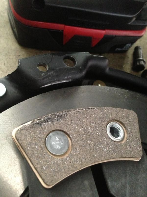

so we went and took the transmission off (now ive done this and clutch jobs at least 75 times to date) inspected everything. notice the ceramic has fallen off here and there. i also notice the rivets were grinding down pretty bad.

the clutch that was in there previously is the same clutch so i know it will work. upon trans removal i notice the clutch disc is bigger than the pressure plate. no idea why it would be like that. it grind grooves into the pp from the tip of the clutch. pix will be up later.
i dont think there ever was a big spline b16 cable trans. and if the clutch that you had before was hitting the pp then clearly it would not be wise to use the same clutch. why dont you just get an oem clutch and pp for a 90-91 integra.

the previous/old clutch did NOT hit the pp, it was the new clutch that was doing it. i found that after taking the trans out again today that it was chewing. so the clutch could be the culprit of the problem. it will be returned tomorrow and refund for a new kit.
ah ok so you have a later big spline, got it. it sounds like the clutch disc is the wrong model fo some reason and doesnt like that pp. that definitely sounds like the culprit to your problem as the drag from rubbing on the pp would keep it from diengaging properly.
