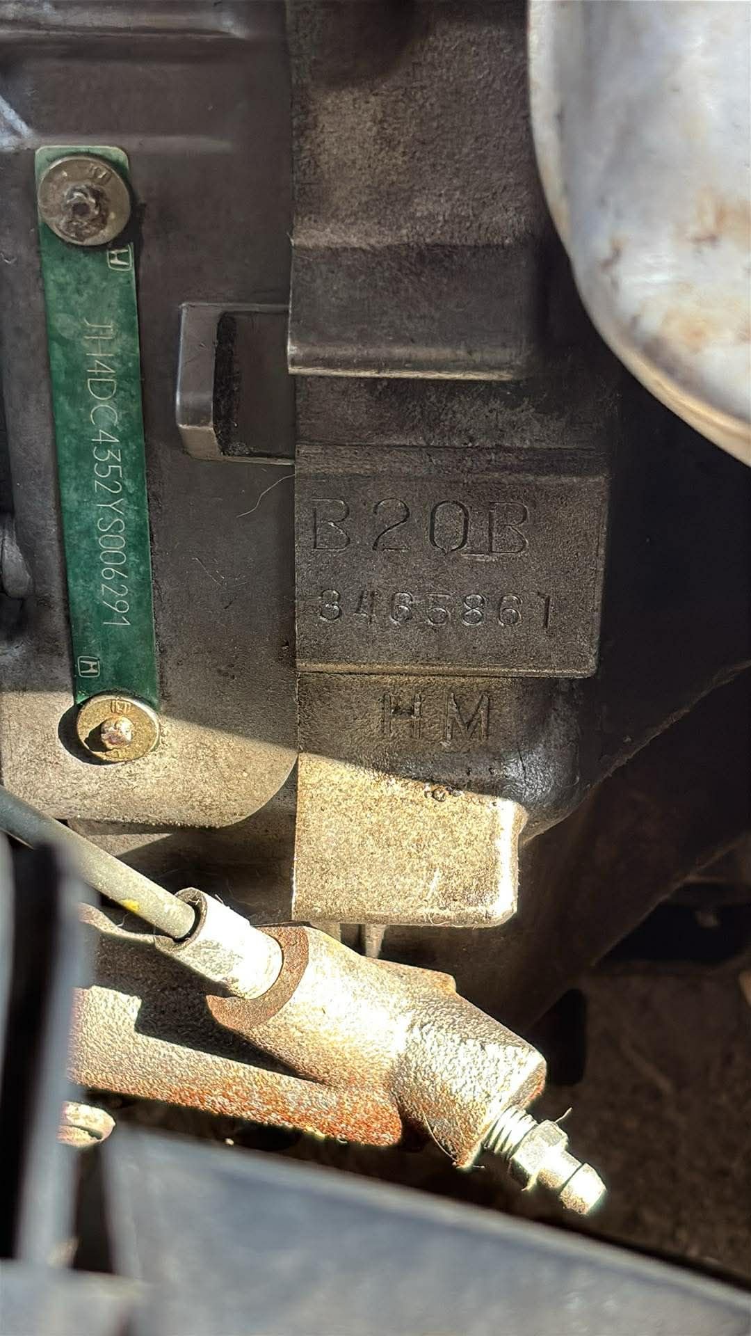

I have a 2000 Integra w/ B20B. Engines running poorly and CEL is on do to the cat. For daily street driving, is it better to replace it with a high flow cat or test pipe as we don't have emissions inspections here in Oklahoma? My concern with a test pipe is I don't want to make myself or my daughter sick from exhaust fumes as we have sensory disorder.

My car is OBD2. In the case of a test pipe, I'm finding a version labeled as a "resonated test pipe". As to improved cats, I've used a direct fit Random Technologies high flow cat that as certainly better than stock. Since I've never used any form of test pipe before do to having lived in states with anual safety and emissions testing, they are new to me. The guy that claimed all B series are the same is an idiot.
