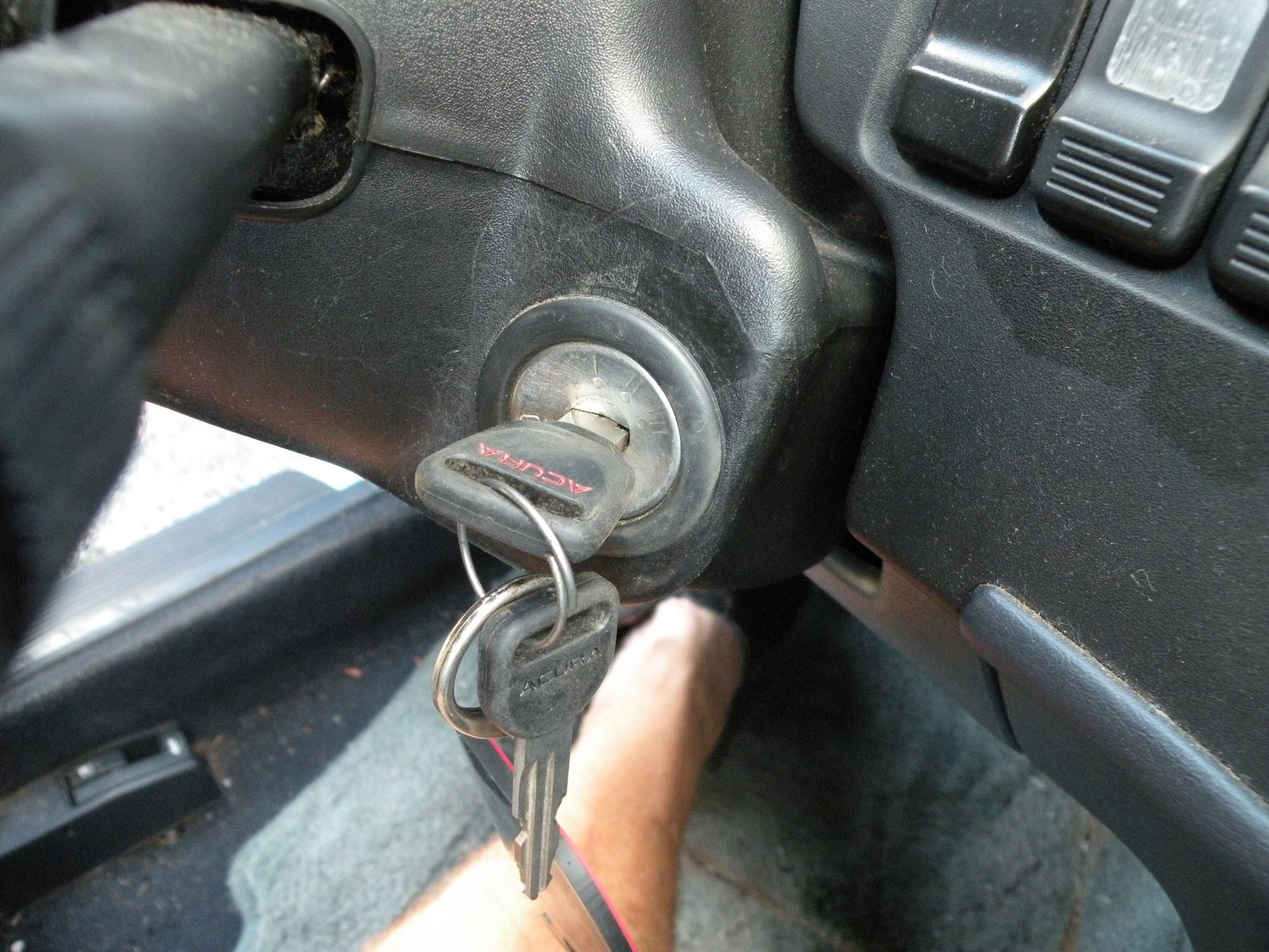

Default Re: Chance to buy an unmodified 92 integra with bent valves
There are so many options on the net to buy a rebuilt head. Where would be a good place to get it? I haven't explored local options yet.
It has a pr4-5 casting.
92 rs with 113k and i'm the 2nd owner. it has rollup windows and manual mirrors. There is some rust but nothing hateful.
