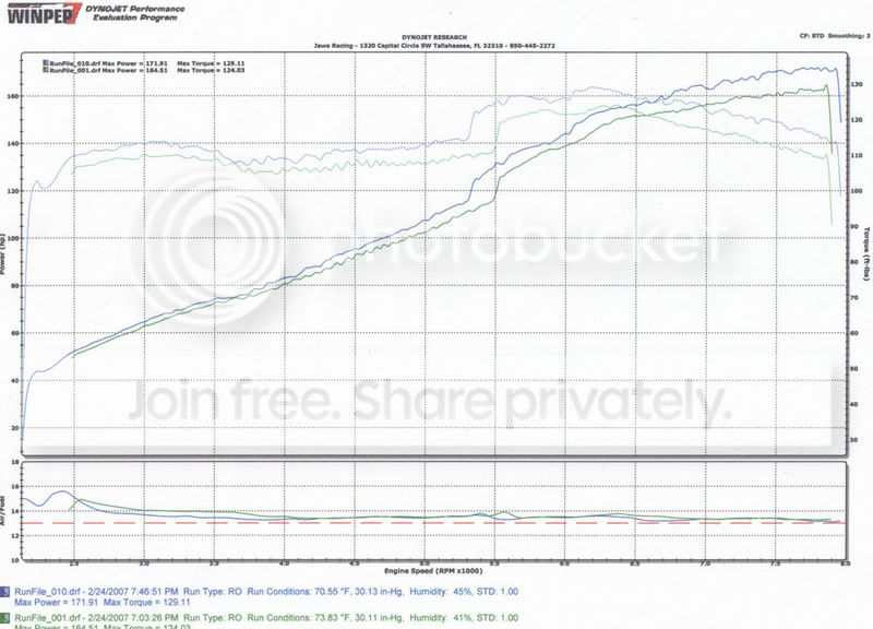

Here is a dyno from a guy I know who dynoed his car last weekend...Mind you his car was street tuned on the first run and then the next run was after he tuned it on the dyno. He picked up 7 hp and 5 lbs of tw w/dyno tuning over his street tuning.
b18c1
Skunk2 IM
Buddy Club exhaust
DC sports 4-1 header
Aem intake
And that 's w/STOCK GSR cams. I'm hoping to hit mid 170's w/my ITR cams/cam gears and whatnot.
