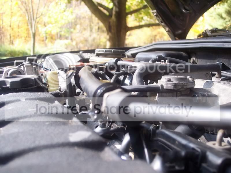

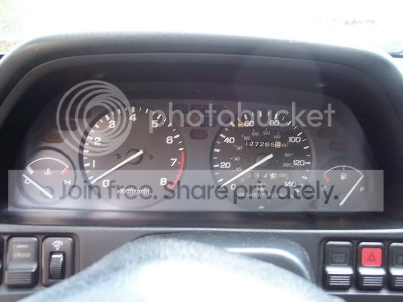

oh well...the upside to doing the AT-MT conversion besides the fact that it's 5-spd is it's real easy to just install your performance clutch, pp, and flywheel since the trans is staring you in the face.
i installed a clutchmasters stg 1 clutch and pp, and a clutchmasters 8 lb aluminum flywheel...
here's everything that i had before i did the conversion:
and the after:
ok enough pics for me...
