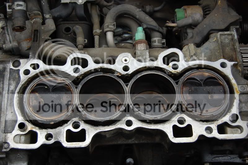

I pulled my head off to replace my head gasket and ran into this!! I don't think I've ever seen anything this bad before. Even the edges around the deck have chunks missing. Funny thing is, even though my B16 had this much damage and a blown head gasket, it RAN like a dream! gotta love Honda right??

That's not normal.

Looks like someone left radiator flush in the coolant or some other kind of caustic solution. Also, I sent you a PM

that is not normal, you have alot of corrosion and chucks missing from the block and sleeves.

I think its time for a fresh motor build !!!

Yeah, That block is done for now, I'm just happy that my head seems to be fine. I just won a B17 block on ebay, so a fresh rebuild is on its way.

resurface your head and get it pressure tested just to check everything is ok before you do your build...

Yeah, thanks for the tip. I'm going to have it all taken apart, cleaned, resurfaced and put back together again. I don't want to risk running into this again in the future.

LOL that is caused because of a bad grounding system in your car.
stick around so learn a few things or two little grasshopper...
Old May 27, 2008 | 08:29 PM
projectTeG's Avatar
Posts: 7,421
From: jacksonville, fl
Default Re: Is this amount of damage normal? (mr.beeks)
<TABLE WIDTH="90%" CELLSPACING=0 CELLPADDING=0 ALIGN=CENTER><TR><TD>Quote, originally posted by mr.beeks &raquo;</TD></TR><TR><TD CLASS="quote">
yea, along with cavatation erosion.
electrolysis isnt that fun( gotta learn to keep ground systems in working order and coolant flushed!)

I run Distilled Water, (supposedly helps prevent electrolysis) and a rust inhibitor along with Redline Water Wetter.

its just a matter of maintenance and checking grounds are correct..
what the tune up is supposed to be.....

ok gotta question for ya! what if you have aot of grounds, i know that might sound like a dumb question, but it was just a thought.
never a dumb question the only dumb question there is, is the one you never asked.
grounds are needed so this doesnt happen specially from engine to chassi.

dang I never thought of electrolysis. So the chemical breakdown of antifreeze can erode aluminum then hmm?
