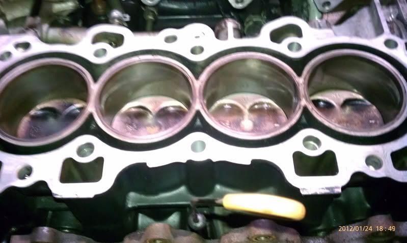

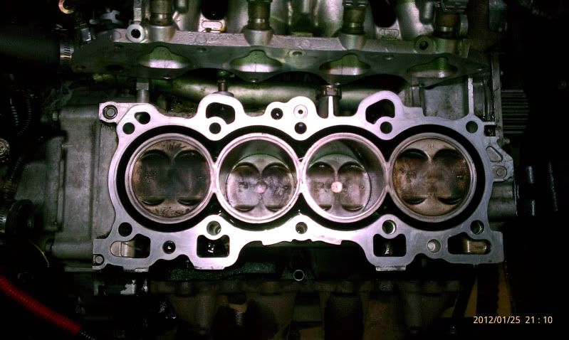

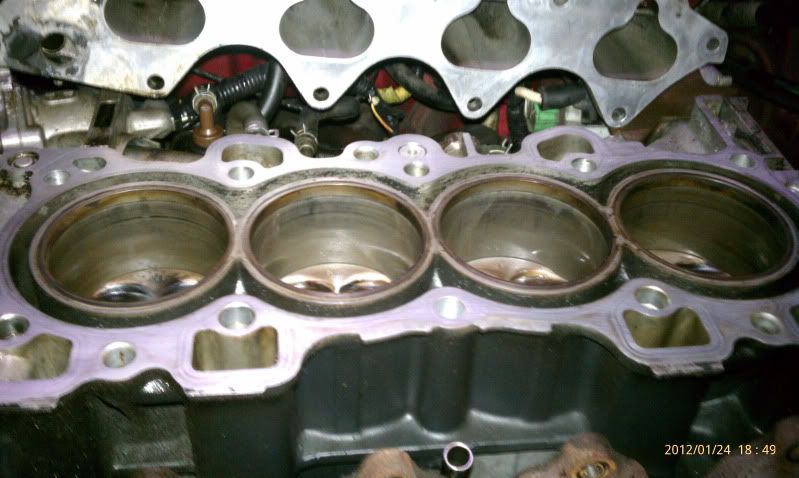

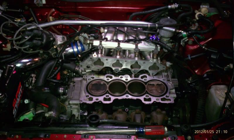

ok so the heads off and looks like burnt valves.
so $275 and the Machine shop and ill be back together.
i have also decided to do the rings sence im already here and i have the parts.

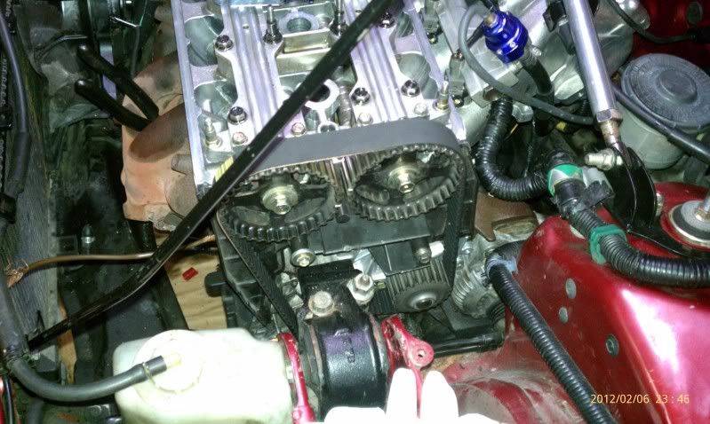

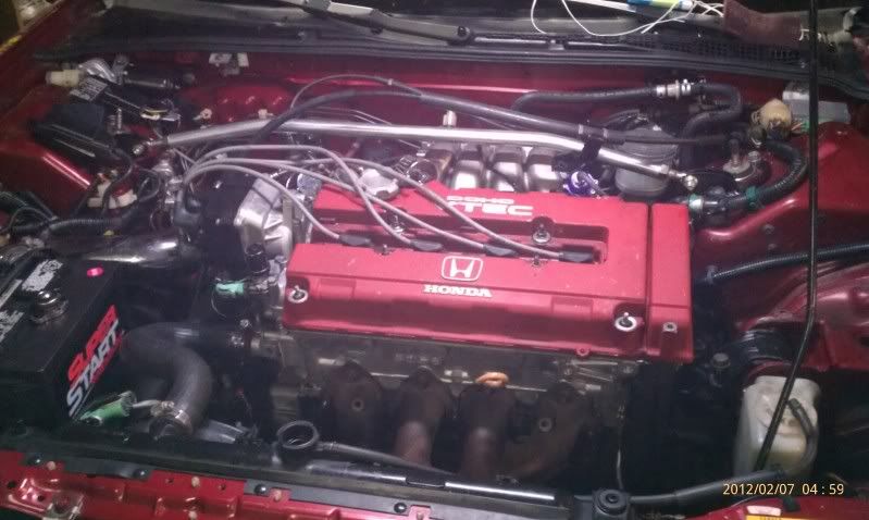

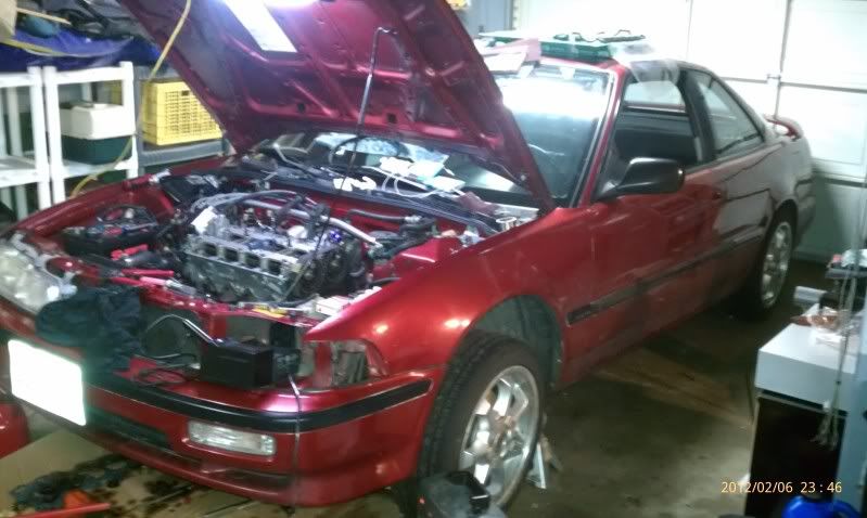

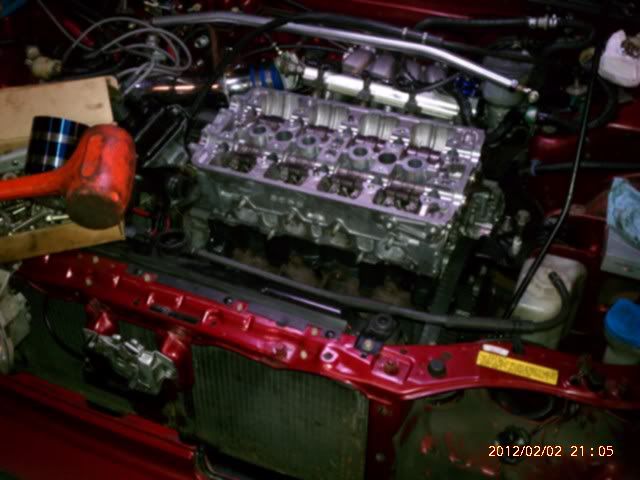

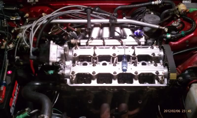

Ok so i haven't posted back for a little bit so here it is.
got the head back and all the main bearings installed and every thing back together.
i'll post Pix of the parts i pulled out later but lets just say it looked like the motor was biuld with used parts from god knows where.

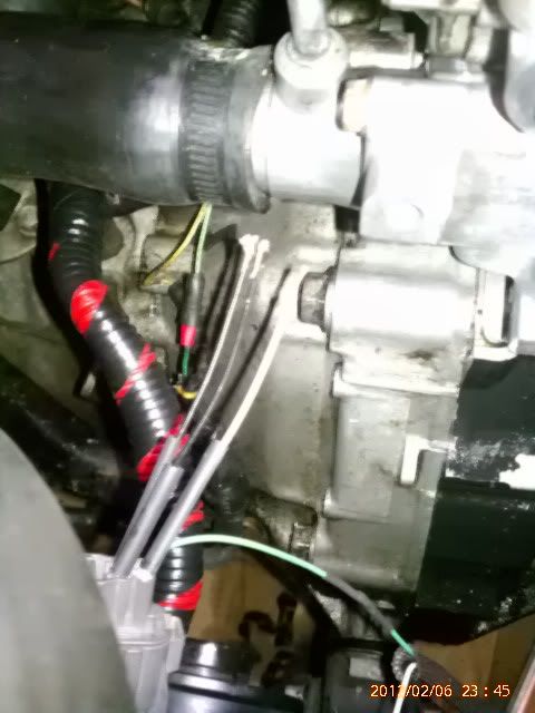

I even took the time to saolder in connectors for the O2, Dissy and Vtec that the last ******* had butt connected directly to the harnnes.

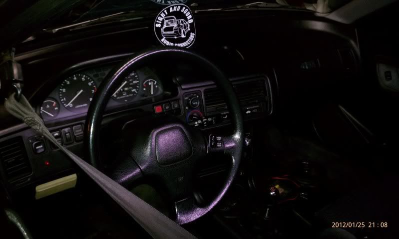

When i was waiting for the head to get done and the parts to come in the mail i worked on repairing the interior.
All i have left to do is finish the rewirering of the passenger head light find some H4H bulbs raise the car up about 2"~ 2 1/2" and figure out where the hell the water in the trunk is coming from and i'm set.
