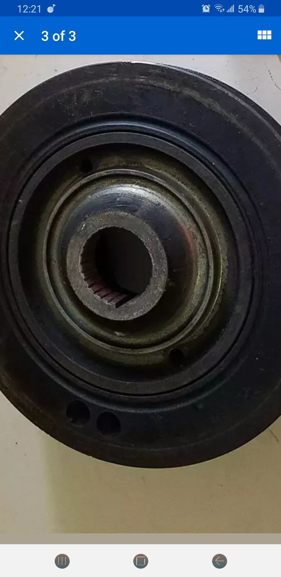

Check to see if your crank pulley (harmonic balancer) has gotten bad. It's 2 piece with a rubber bushing. If the bushing goes bad, the alternator pulley, won't spin with the crank, or only spin xx% off the crank pulley.
Would that help not keep the car staying running? Sorry county think of another way to say that.
