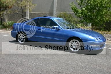

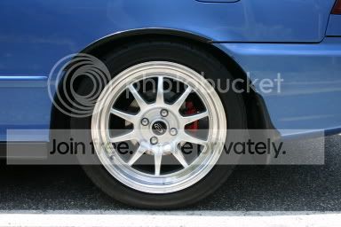

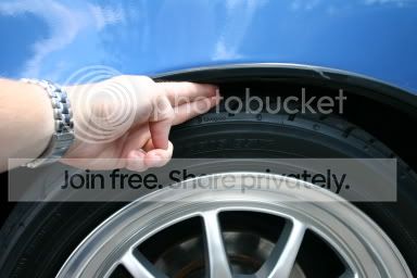

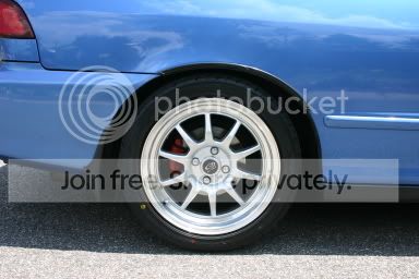

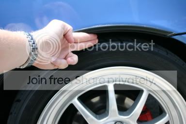

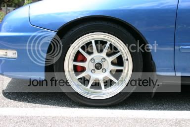

I just got a set of 205/45/16 Yokohama AVS ES100s mounted up on my new 16x7 Rota GT3's. The tires are rubbing, but I'm not sure why. The car is lowered on H&R Sports (1.75 in front, 1.5 in back), and I just put in a camber kit. Prior to these wheels and tires, I had 17x7 wheels and 205/45/17 tires, no camber kit, and there was no rubbing.
I've never come across anyone (lowered or not) that has had a problem with this size tire rubbing on an Integra. I posted this over on Team-Integra, and the consensus seemed to be that new struts would fix the problem (I'm on the stock struts now). Anybody have this experience? Or have any other suggestions?
Here are some pics:

What is the offset of the wheels? I'm guessing the offset is too low (tires sticking out too far) if they are scraping the outside edges on the fender lips.

I actually don't know what the offset is. The tires don't appear to be rubbing on the fenders, though. (Or a least I can't see anywhere they've rubbed on the outside.) I think they're rubbing on the inside.

It should only rub the inside on the front wheels if they're turned all the way full lock, and if the wheel offset is too high (tires too far inwards), but yours don't look like that. Look around the wheel for some writing, maybe on the inside of the wheel and find something like +45 E.T. or something similar. That's the offset. If it's lower than probably 42 then most likely the outside of the tires are scraping on the fender lip when you go around a corner.

The problem is definitely your offset.
It's easy to tell, because the 205/45-17 size you were using is MUCH TOO BIG for a teg. The 205/45-16 is the proper 16" size, and it's a full inch smaller in diameter than the oversized 205/45-17. (Are you sure you weren't using 205/40-17? That's the proper 17" size for a teg.)

Yep, offset is most likely the problem. Stock 15x6 wheels are +45 offset. So when you put on 7" wheels, you get an extra 1/2" on the inside and outside (12.7mm), then add another 5mm because the center line of the wheels sit 5mm farther out with +40 offset than with +45 offset. So the outside edge of your wheel is 17.7mm farther out (about 3/4") than with stock wheels and tires.

Do you have a camber kit on the rear? If so you now have it flush with the rear fender lip. Instead of your tire tucking at an angle(when you had negative camber). It's now going straight up over bumps and hitting the fender lip.

Just thought of something, what are your camber angles with that camber kit you just put on? If it's straight up 0 then I'm guessing that's your problem. Get it adjusted to around -1.5, or just take it off (not really needed anyway) and you'll be fine.

your rear camber kit is to close to stock specs like others had said. my friend had a similiar problem with his ef and 17in whels. just get another alignment and add some rear camber(negative)try not to go over -2 degrees other wise you might run into understeering problems. i ve used offsets of 40-42-45 on hondas and they all work.i have 16 in rotas on my da with 205/45/16 with a 40 offset with no probs. get the alignment it will fix it.
