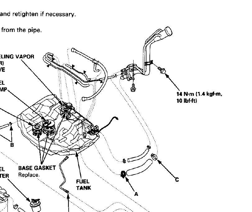

In my Helms manual, it shows 2 breather tubes on the filler pipe. Weird...

I contacted the distributor, as well as the company who manufactures it and they never heard of this issue before. The manufacturer also suggested that the breather tube on the filler pipe is the problem. There are two of them on my car, as you can see in the picture above. I really pressed the issue to see if there was a possibility that the valve may be faulty, but wasn't offered a replacement. I don't think there's much that can go wrong, I guess. I went over with them exactly how and where it was installed. I'm using it for its intended purpose.
