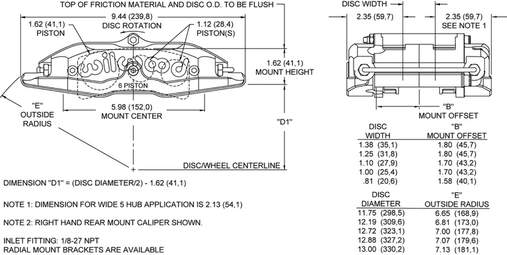

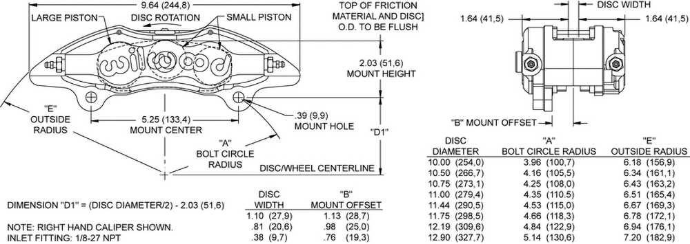

Here are some fitment pictures. The ID where the spokes meet the wheel is the critical part. I don't have a ton of clearance there, but behind the spokes, there is PLENTY of room.

No, it's an SL6 radial mount caliper. The one I'm using is MUCH wider than the Dynapro 6 in that kit you linked.
Mine:
The Dynapro 6 from that kit:
The hats in that kit use a slightly shallower offset (0.45" vs 0.54"), so the rotor would be pushed outward just a tad further than my setup. I would not expect that to fit any 15" except MAYBE the Team Dynamics Pro Race 1; however the TD PR1 wheel has an ID that's similar to most 16s. I'd bet that there's no way these would fit with a RPF1 wheel. Using Wilwood's measurements, the Dynapro 6 requires a minimum radius of 6.94" to fit a 12.19" diameter rotor. My SL6 requires 7.07" for a 12.9" rotor. It seems the SL6 fits much more tightly against the rotor and requires less room inside the wheel. I just don't see how that Dynapro 6 is going to fit inside a 15" wheel...
The brackets are custom to fit the rotor and hat combo I chose.
