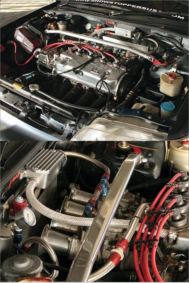

Here's a D16A6 all motor with 200WHP DD (carbed not injected)...
<TABLE WIDTH="90%" CELLSPACING=0 CELLPADDING=0 ALIGN=CENTER><TR><TD>Quote »</TD></TR><TR><TD CLASS="quote">Propulsion
Casino's EF6 relies on a D16A6 sourced from his '89 USDM CRX Si. Bore equals 78mm thanks to Exospeed-designed 12.0:1 Arias pistons. Custom length Eagle rods clamp down to the factory crank via ARP rod bolts, resulting in a longer 90mm stroke. Displacement measures in at 1720cc.
Industrial Performance of Carson, Calif., performed its signature-series port and polish on the head as well as a three-angle valve job. Stainless-steel, nitride-coated valves are housed between ISKY race springs and below ISKY titanium retainers. A custom ground Exospeed camshaft is fine-tuned with an AEM camshaft gear.
Weber 45mm side draft carburetors and TWM runners bolt up to the SOHC head. The larger carbs were selected based on their top-end capabilities and their ability to work best under high compression. A Mugen header and Mugen teardrop muffler evacuate exhaust gases.
Fuel enters the Webers with the help of a Holley fuel pump and an Aeromotive adjustable fuel pressure regulator. Ormes Bros. hooked up the steel braided fuel lines and custom fuel rail. With no ECU, timing events are controlled with an MSD 8980 timing controller. Spark's enhanced with NGK V-Racing plugs, MSD 8.5mm wires and an MSD distributor cap.
The gearbox was also sourced from Casino's '89. Close ratio Exospeed gears are outfitted to the L3 transaxle as is a Quaife limited-slip diff. Before installing the gearbox, Casino installed an Action dual diaphragm, six-puck clutch and an Exospeed aluminum flywheel.</TD></TR></TABLE>
