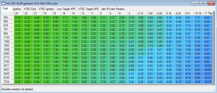

I need some trained eyes on these to get your thoughts. First of all...yes, I'm OBD0! No, it's not obsolete in my mind. I'm using BRE (Ben's Rom Editor) software and I have an old EPROMER6 programmer and using ATMEL29C256 chips. It's a little old school - I burn a chip and plug it directly into the ECU, but it works.
Car 91 CRX HF, b16a, Turbonetics T3/T4 (.63/.60) 8-10psi, DSM 450's bar & plate intercooler 2.5" exhaust, straight-thu cat, no muffler (flows good). I have an APSX D2 wideband gauge, bosch LSU 4.2.
For some reason, at idle, I'm getting around 18:1+ AFR's. I've enabled the o2 sensor in the tune (I have it wired to the simulated narrowband) and it tries to bring it down but ends up running very, very rich so I've disabled it. So much so, the car wants to die. I think I have a small exhaust leak causing it to misread at idle. If I blip the throttle at all, it brings it right around 14-15:1. With the o2 sensor disabled (in the tune), the car runs AWESOME. Good AFR's all through normal driving (13.5:1 - 14.5:1) and about 11:1 - 11.5:1 under full throttle boost. Car feels very powerful and I don't hear any spark knock. I believe I have my fuel tables where I want them but I would like some trained eyes to look at my low and high cam ignition tables. Let me know if anything stands out or if there's concern. (tables below)
Btw, this is absolutely NUTS in my mind, but I have checked my MPG several times and I'm consistently getting over 35mpg... in the city! I haven't taken any highway trips yet. I have a fairly short commute to work where the speed limit is never over 50mph, but I couldn't believe my miles per gallon. Pulled my plugs a few times and they look good. My previous crx was a 90 SI with a boosted ZC (small turbo) and I would get around 25 in the city. I guess the bigger turbo does better under normal driving.
Tables:
LOW CAM FUEL:
HIGH CAM FUEL:
LOW CAM IGNITION:
HIGH CAM IGNITION:

OBD0 is not dead at all - I have several customers here in Puerto Rico running on BRE and TurboEdit...
What do your target AFRs look like?

I'm pretty happy with where my AFR's are but I wanted to make sure my ignition tables were ok (low cam & high cam). They seem a little advanced when I compare to other base tunes I've seen. I just want to make sure they're not too advanced.
My target AFR's are:
idle 15:1 - 16:1 (remember I'm not getting an accurate idle reading for some reason. If I enrich it in this area, it runs too rich so I believe this # to be lower)
light cruising 14.5:1 - 15:1 (20-15" vac)
highway cruising 13.5:1 - 14.5:1
low boost (0-4psi) 12.5:1 - 13.5:1
midboost (5-7 psi) 11.5:1 - 12:1
upper boost (8-11psi) 11.0:1 - 11.5:1
I ran my wideband ground back to the engine block (basically on top of the t-stat housing on distributor bolt) and recalibrated the o2. That seemed to make a difference from where I had it grounded under the steering column.

You need to do some work in your timing tables. You need to advance it when you're revving higger. If you are running 24* at 8000, you will need near 23 at 7500 or so. Now maybe you are passing MBT (near to detonation) in mid range RPM.

what? High rpm low load high ignition. High rpm high load low ignition.
Ignition looks ok..but i would reduce a little bit more timing at the end. Then ur safe and happy

I'm not saying that. What I'm saying is he need to advance the ignition regards on RPM going up. I didn't say anything about load.

Definitely not doing any more advance in the higher RPM, higher boost. My concern is that I'm already too far advanced. I could bring them down a notch in the 9-11psi for more retardation.

Ive been running bre for 3+ years now with good success. Are you using any form of knock detection? Im leary of street tuning ignition tables to their fullest potential without any knock detection. My tactic knowing this with my setup, im not going for full max hp potential. I basically and very archaically copy the last colum in before boost and paste it across all boost columns, than retard .65 degrees per psi. Its very conservative, but I have ran a friends comptech stage 2 si that made 290whp amd we were door to door. His car has since blown up, my self tuned obd0 b16 turbo is still healthy as a horse. Ill take a closer lool at your maps in the AM. Has far as timing in vacuum, I have stuck with thr OEM timing, and I get consistantly 38mpg highway(hand calculated).
the o2 is buggy with BRE. Ive tried using narrowband simulation and the o2 for years and could never get it to run correctly. I even installed an oem o2 and used that instead of the simulation and still wasnt right so now I simply rely on my maps and constantly tweak things here and there. Would you mind sharing your bin file at all so I can open it up in BRE?

Glad to hear you've had good success. I like the idea of your ignition timing retard per psi through the columns. I've never been able to get the o2 right. I had trouble even before turbo, but mostly after I tuned with the 450cc injectors. The o2 would overcompensate and make it run too rich. I have a little dead spot in my tune around 20" (need to add a little fuel), but the tune by itself runs so good and I'm getting incredible mileage. I'm at work but may PM you the .bin later when I get home. I may like to look at yours as well if you have it.
My ignition tables are slightly more advanced in vacuum now (changed since I've posted those pics above). I've done some research on advancing the timing and going a tad on the lean side under normal driving conditions to increase mileage. I need to get an EGT sensor to monitor things a little more, but my fuel is conservative in boost.

Other than that, I realized my original tables/map was too advanced under boost condtions (both low and high cam). I took your advise and essentially copied the last column of ignition prior to boost, and used bre to automatically retard igntion per psi of boost to about .50 to .70 per psi boost and just a tad more above 10-11psi. I think my original timing could have done some damage based on my new #'s. I think my math was off originally..
Here are my updated, safer ignition tables...
LOW CAM IGNITION:
HIGH CAM IGNITION:
