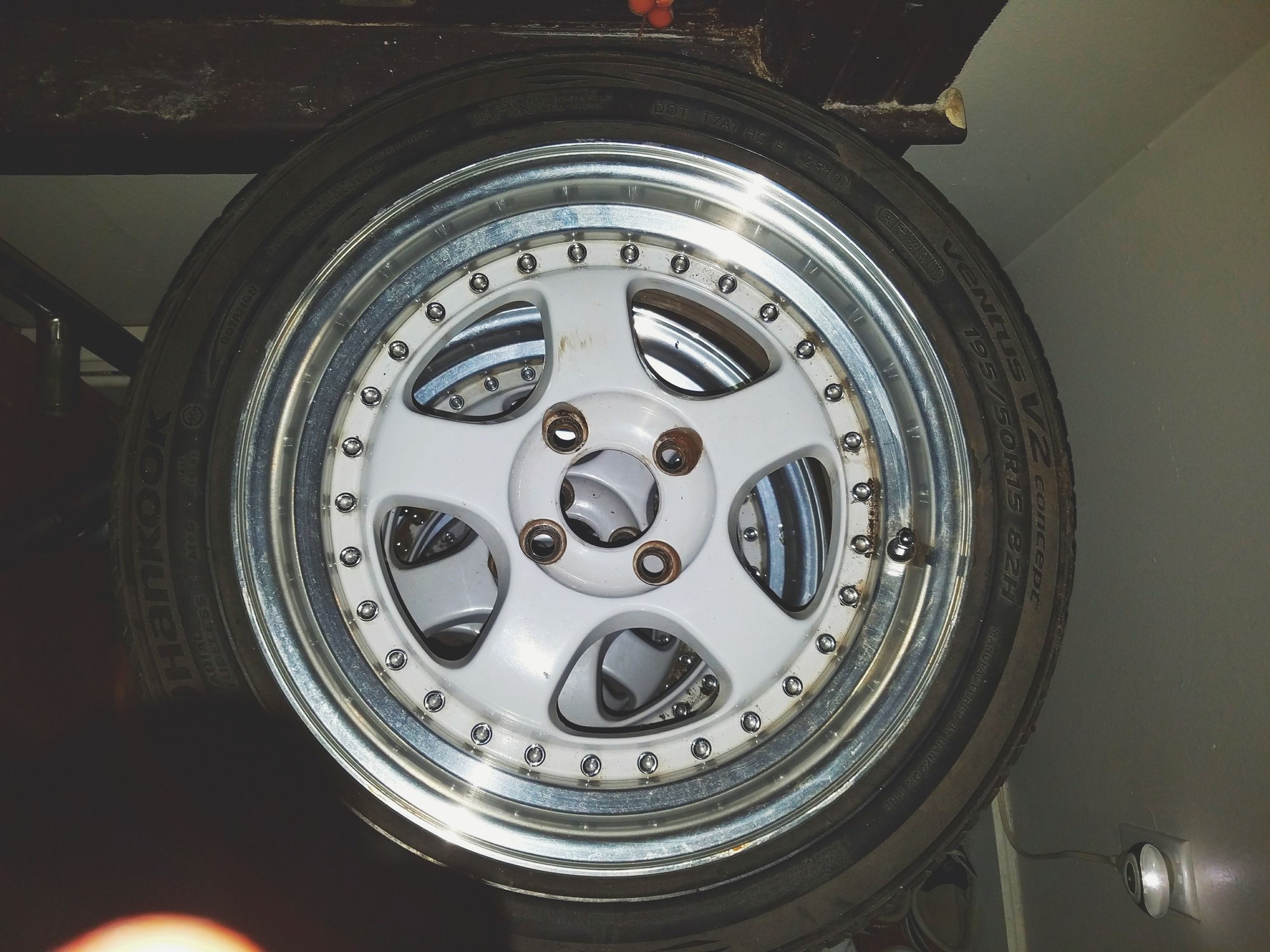

Hey guys im new to the honda world, i just picked these up for my 99 civic.
Do they have a name ? Also my car is currently stock height but i plan on lowering it soon on h&r springs.
Will i have any fitment/rubbing issues or will i be ok. I believe the specs are 15x7.5 15 offset. Thanks

Replica of the SSR SP1, and a bad one at that.
You might have some work fitting those user stock sheetmetal, it'll be close if it does fit.

so ill have trouble fitting these at stock height or when lowered?

Konig Candy
(Model of the wheel)

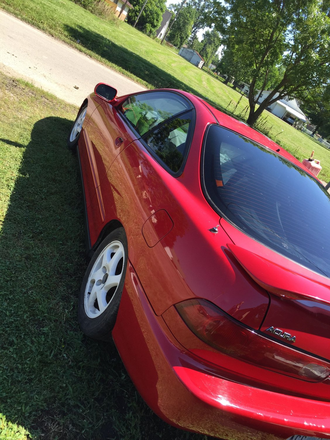

You shouldn't have a problem fitting those lowered or at stock ride height. I have the same 195/50/15 tire size on my 1996 Integra and I never scape. I'm pretty low as well.

Your 15x6.5 +45 wheels are far from the same fitment as the requested 15x7.5 +15's in the first post (roughly 1.5" less clearance to the fenders/quarter panels on the Konigs when compared to your wheels). So, to be fair, you're comparing apples to oranges here.
